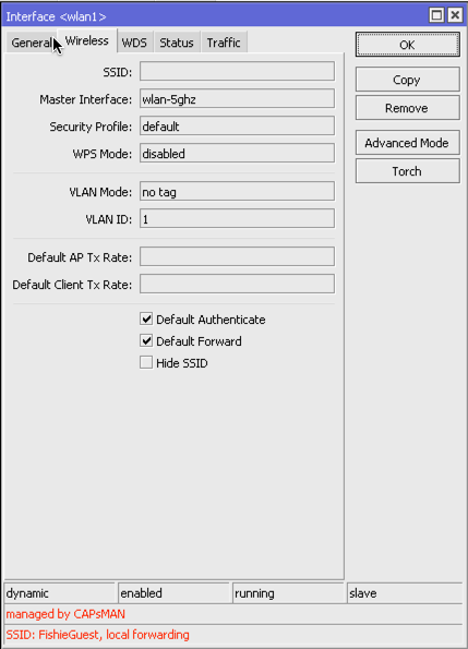

Right now I am having issues getting the VLAN tagging to work… the provisioning information on the CAPsMAN is indicating VLAN tagging, but the interfaces on the CAP itself say no VLAN tagging…
-Eric
It seems that no matter how I configure the VLANs if I look at the settings on the CAP the interfaces always say “no tag” and “1” despite it showing as “use tag” and “2” on the CAPsMAN.

Enable LF in campsman and use tag option. This config is not showed locally in CAP but is applied and working. Almost all config showing in wireless interfacein your CAP is dummy info if you access your CAP locally !!! Has sense since It is managed from outside!

What is odd to me is that if you go into the Virtual AP on the CAP there is stuff under the wireless tab that “looks” like it should be filled in… it’s just wrong… see image below…
VLAN Mode and VLAN ID theoretically are use tag and 2… which are shown on the CAPsMAN… but not on the CAP. Seems od to me that the field exists if it doesn’t have proper information in it.
I’ll try to make you understand it again. You must think in the way the radio is not local (remote device related) anymore. Think the CAP radio is a CAPSMAN router local radio and forbid the CAP showed config.
