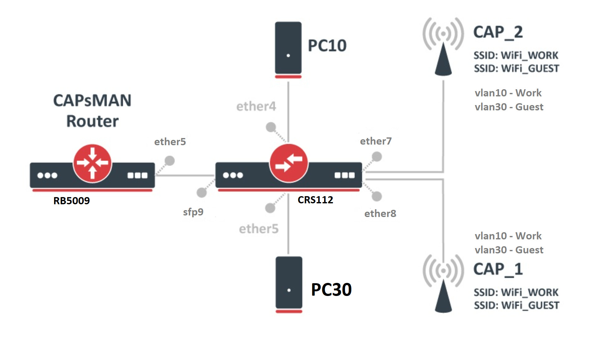

Can you provide a small drawing ?
Here is a slightly modified drawing showing the interfaces/vlans in use. I had it working on a tagged trunk to the cap, but trying to follow the manual for capsman forwarding through my crs switch.
