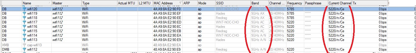

When I provision the 5G radio, I see unter Wifi the correct bands but unter current channel only the band of the master interface (see attachement):

Slave config will always follow the physical part of master.
That’s normal.
You can play on slave part with ssid, security, fast transition, … but not channel nor band, those will be taken from master.

Thx for the information. Had problems with some devices with ax band. I will configure it then accordingly.
Okay, so I will create an ax band with lower security to provide “older” devices with the correct security mechanism on an and ac bands.
