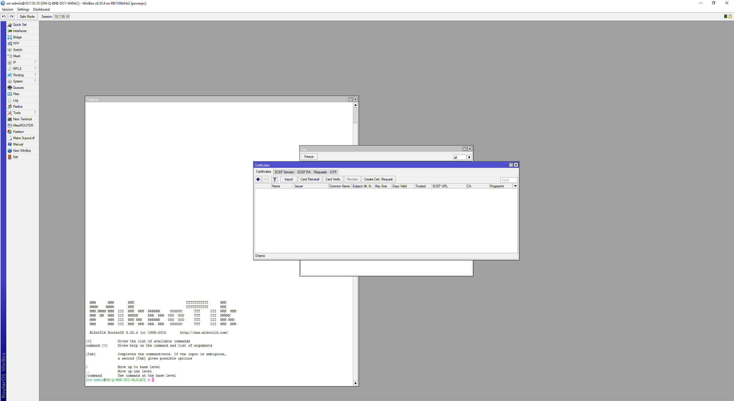

However i am using a RB1100ahx2 and i dont see a CAPsMAN option, i have searched around and havent found anything useful,
never mind i found the packages to enable
is there a preferred package to use ? cm2 or fp?
Use cm2, fp will be discontinued.
