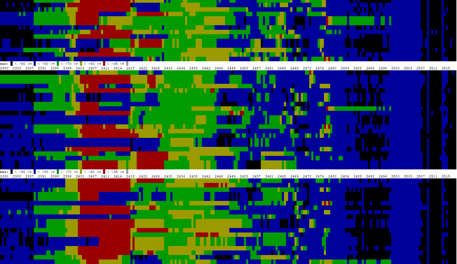

Scan the area with the slow speeds with the following command. /interface wireless spectral-history wlan1. Post a screen shot of the output. You may have some type of interference in the area.

Attached is the spectral scan.
Thank you, I missed that where you had tried it stand-alone. Well, then its an issue with the cap manager. I don’t use that feature. I don’t know how to help you further.
