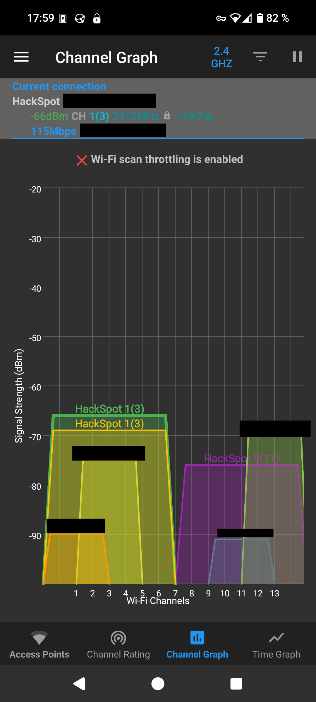

OK, is i possible that the problem is, that TWO of my Caps devices are on the same channel?
This is what Wifi Analyzer shows:
How came to that? Isn’t it so, that CapsMan automatically select and manage channels? Wha are in my case both devices on the same channel?
Perfectly possible if you leave it to auto. Which is why I NEVER leave it to auto. I want to know where my frequencies are (and yes, I am lucky to have most of my devices in areas which are relatively interference free).
At a certain point (and usually that’s at boot time) radio will scan for an unused frequency. If it finds one, it goes further and uses that one.
But it can happen 2 devices boot at the same time, scan at the same time and then choose the same frequency at the same time.
There should be some new parameters with latest versions which can be used to reselect frequency at a random interval but personally, as already indicated, I have no need for it.
I know where my frequencies are.

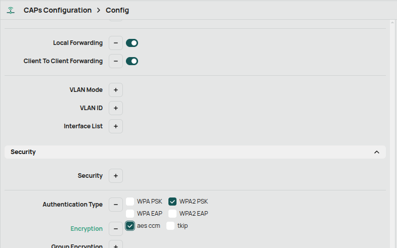

CapsMan (CAPs Configuration > Config) is in AP mode, for authentication mode I have WPA2 PSK, and encryption aes ccm.

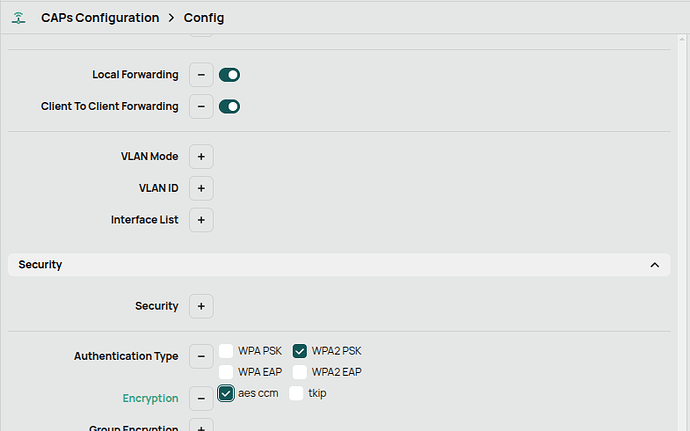

I encountered this problem many years ago. At that time, the wireless encryption was aes/tkip. I set it to aes only to solve this problem.
Hmm, I have this:
And today it is still happening a lot. So it must be some other problem…
