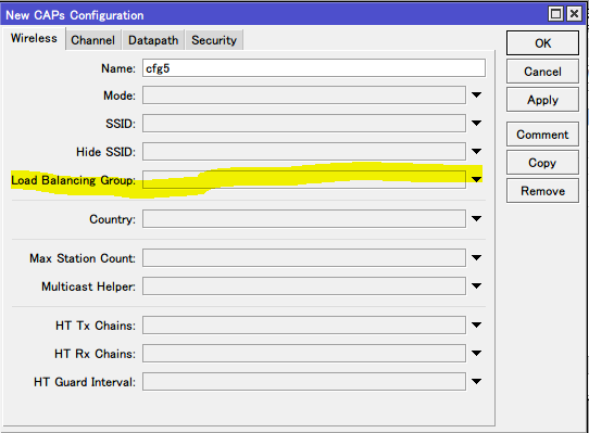

how exactly does Load Balancing work? When I connected just one CAP to a CAPsMAN and added a Load Balancing Group to the provisioning rules, I got
@ rejected, not allowed due to load balancing
Not nice.
It works OK when there is NO Load Balancing Group… huh?
Thank you in advance

Since there is no specific description to Wiki, generally how wonder it is correct to set?
Please explain what it means - load-balancing-group ?
It is this part I have to say.
Also there is no description in the Wiki for Load Balancing Group.
we have updated the wiki on this setting:
“Interface belonging to the load balance group accepts new clients only if amount of already connected clients is less than on the rest of interfaces from the same group.”
Thank you for updating the Wiki.
In short “Load Balance Group” is Grouping is the interface,
the number of clients that house is to be preferentially connected to less CAP interface,
or would be okay with the understanding that?
http://wiki.mikrotik.com/wiki/Manual:CAPsMAN
It means that having 2 caps in group , first has 1 client and second no client, that I am able to connect only 1 additional client to cap 2 and all others will be rejected? And cap1 will not accept any client? How is it useful?
