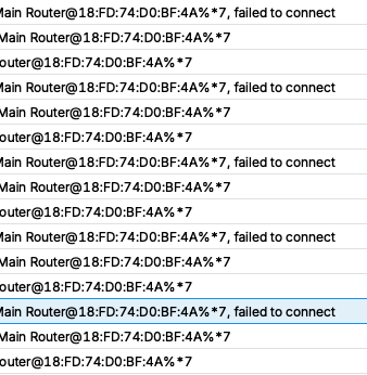

Confirming the same issue. On CAP’s log:
I had the issue once maybe 3 weeks ago. Rebooted 5009 (Capsman and main router), nothing. Rebooted 24 port Zyxel switch, nothing, then i started rebooting all APs on network and it stopped doing this when i rebooted HapAX2 (it happened also before AX2 was put on that place, so it's not device specific). It's like some kind of loop that doesn't stop until you reboot device, that causes problems. AX2 in that place is also switch for 4 more CAPs behind him.
It just throws all CAPs off the network causing connection lost for all Wifi devices every minute or maybe a little bit more.
