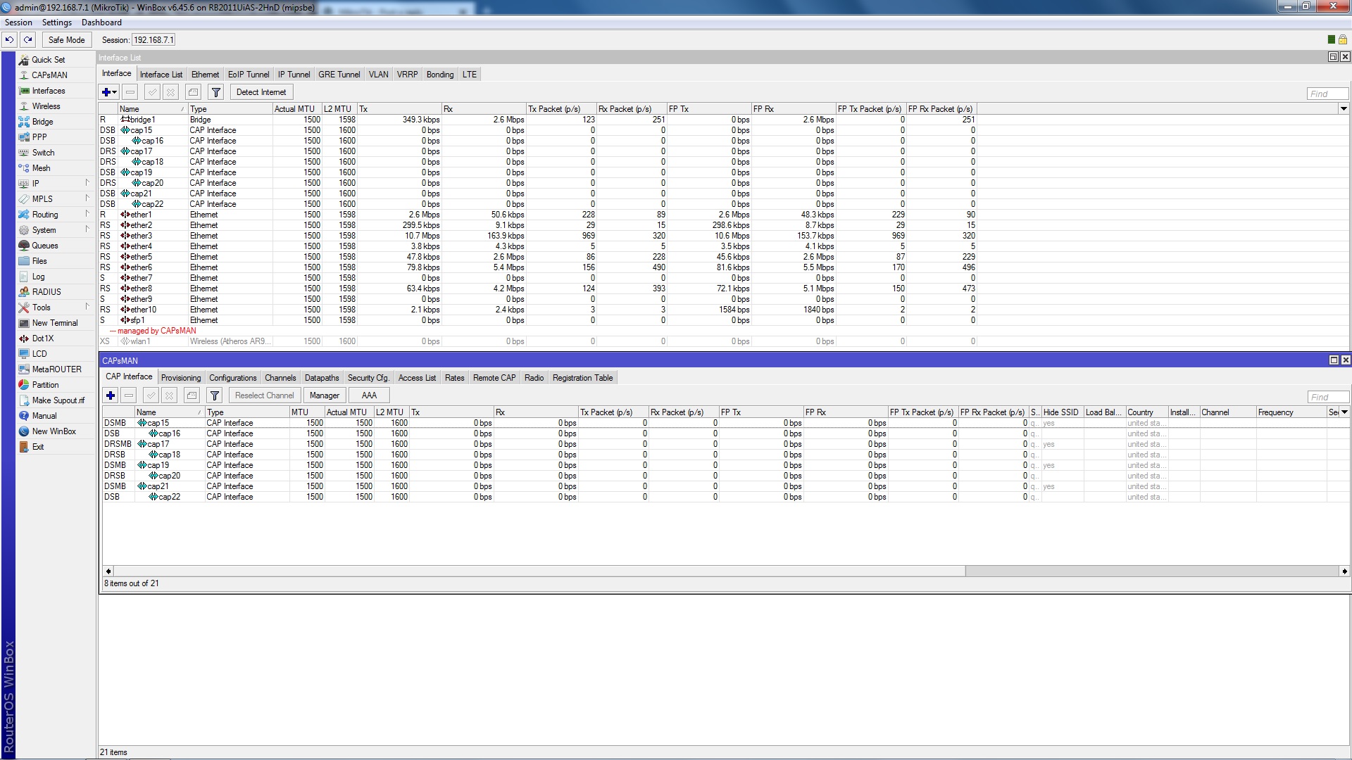

All is perfect, except I cannot make RB2011 act as CAP3 - it has wi-fi, but only the guest wi-fi…and in CAPSMAN settings only cap interfaces for remote CAPs are shown, no RB2011 wi-fi there.
I will try to upload some printscreens to make clearer the issue, but basically what I need is to have my CAPSMAN manger (RB2011) act as a CAP at the same time as being manager.
Interfases on RB2011, my capsman manager. It shows wlan1 as being managed by capsman, but when I go to capsman, I have there only cap interfaces of my 2 remote caps.

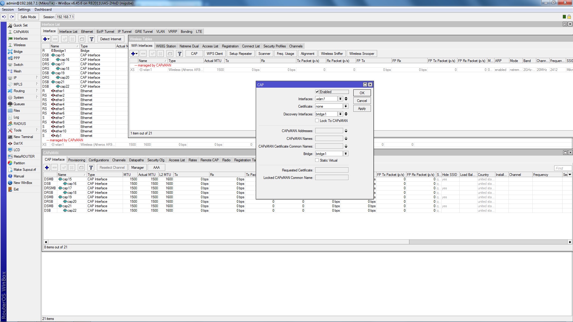

when I check wireless Tab on my RB2011, CAP is enabled on RB2011…

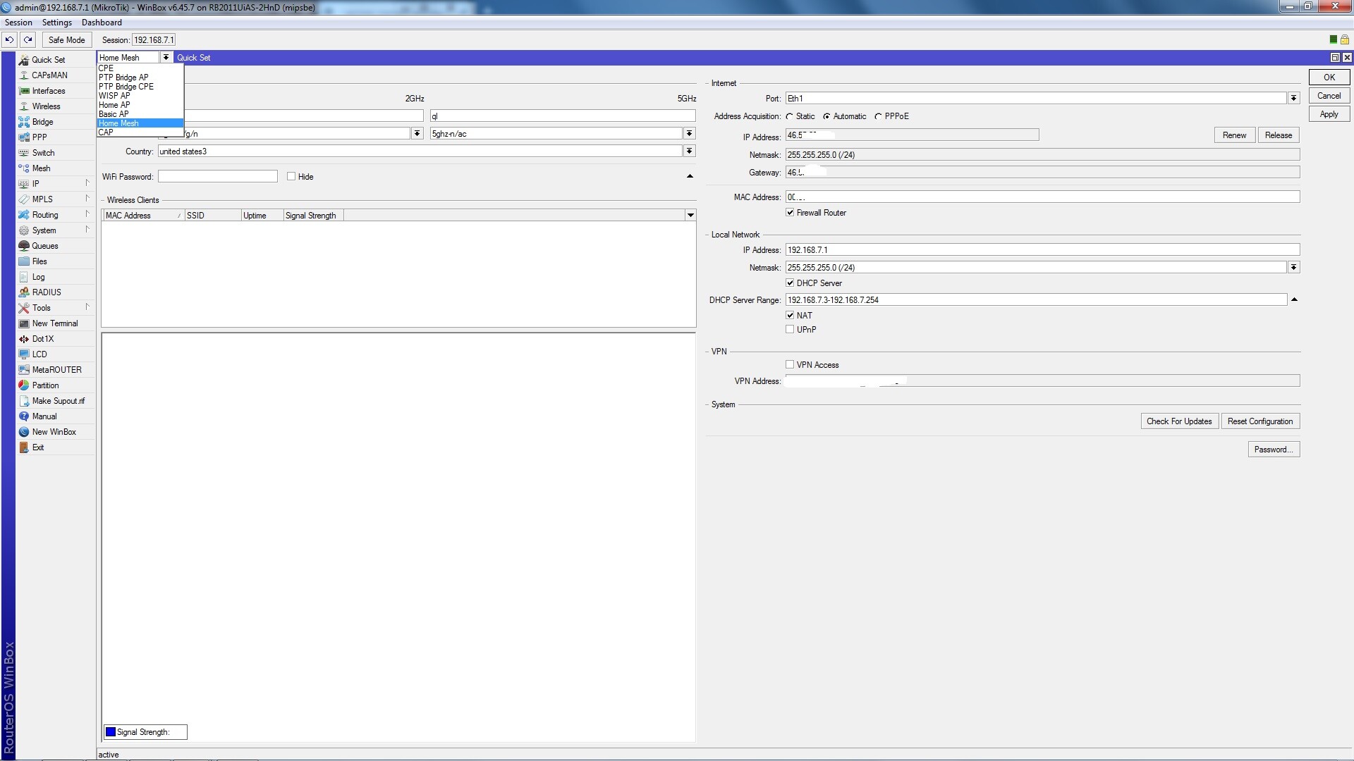

I am at total lost on what else to check to make it work…could it be that when I reset the RB2011 I chose a quick setting of “Home Mesh”?..maybe the problem lies there?

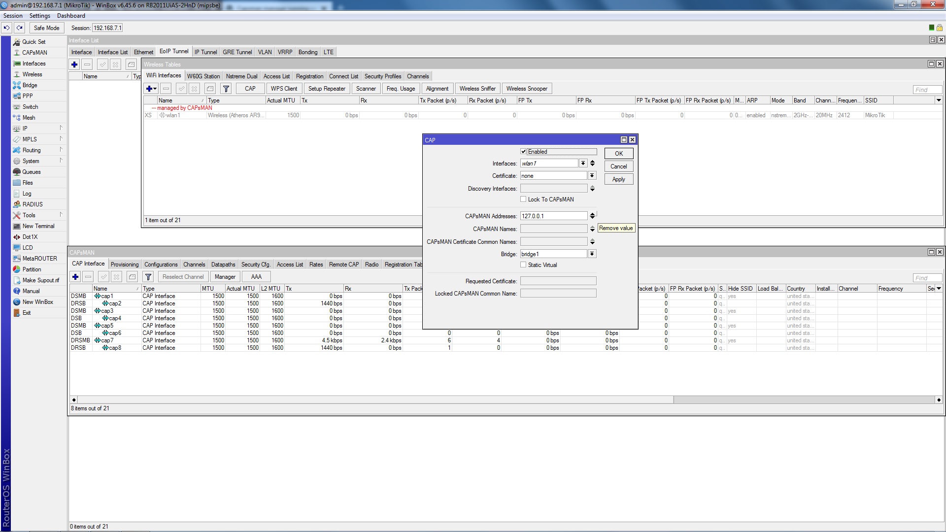

In your local CAP settings, remove discovery interface and add 127.0.0.1 as CAPsMAN address.
-Chris
Many thanks Chris for your suggestion
Like so? Remove discovery interface - I just closed that line in CAP settings, or you mean I need to find a list of interfaces where Discovery interface is like an entry ina list and select “remove” option?
With the changes made on the printscreen, I still have no changes that I can see.

could it be that the main fault is in my initial setting of CapsMan manager RB2011 - I have used quick set option of “Home Mesh” - is this correct?

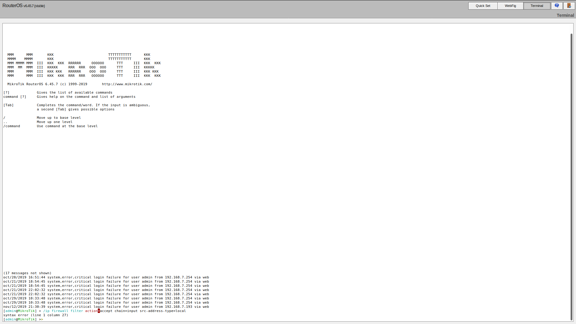

Thank you so much! But I tried this (even with the guidance from wiki manual) can’t make it work. Could there be a mistake in the syntax? It seems in line with the wiki manual..but the commands are not accepted.

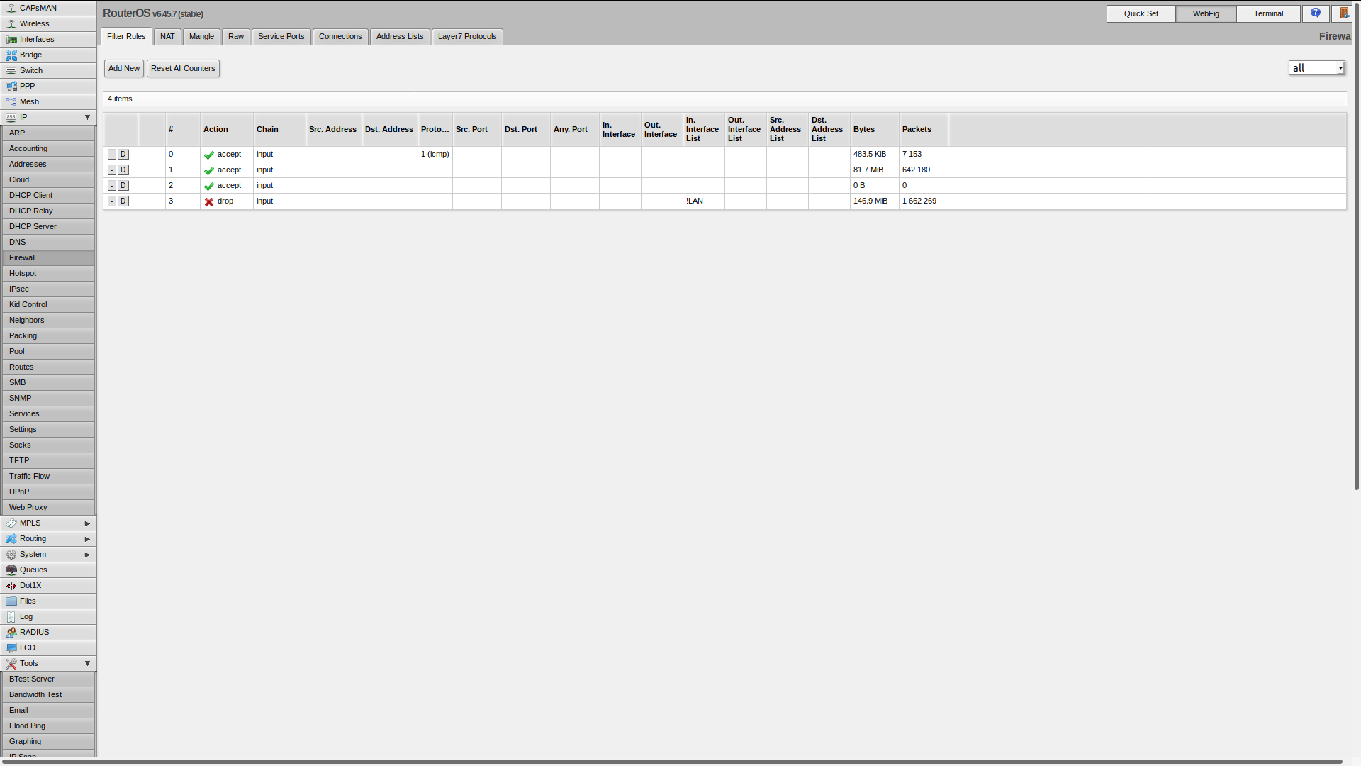

by the way, these are the rules which were previously on the router:

I missed the “add”.
Sorry about that :slight_smile:
/ip firewall filter add action=accept chain=input src-address-type=local
And don’t forget to place it higher than the last “drop” rule.
I noticed that “add” was missing (from the wiki manual), so I tried it with “add” as well. It does not work, but I think the problem is I add it after the “drop” rule. I don’t know how to add it above the last rule (which is “drop” on my router).
Shall I disable the “drop” rule, add the rule you suggested and then enable the “drop” rule again?
Just drag it higher in the GUI :slight_smile:
