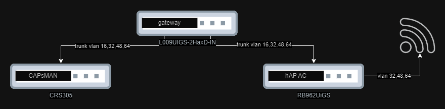

I am trying move old version of CAPsMAN (ac on wireless driver) from my GW as it is now running new version of capsman+local interface.
M entire setup is vlan based and was working on l009, but i must done something wrong on CRS305
In short, I’ve:
  • copied CAPsMAN configuration from L009 to CRS305
  • added local-forward mode to home, guest and iot datapaths on CRS305
  • spitted bridge/vlan configuratin per vlan (as it was trowing error when it was in bulk) on client
At this stage, caps is connecting to capsman and broadcasting proper networks, but I can’t connect to wireless network as there is no DHCP broadcast there.
Connection is roughly like so:
L009UIGS config:
