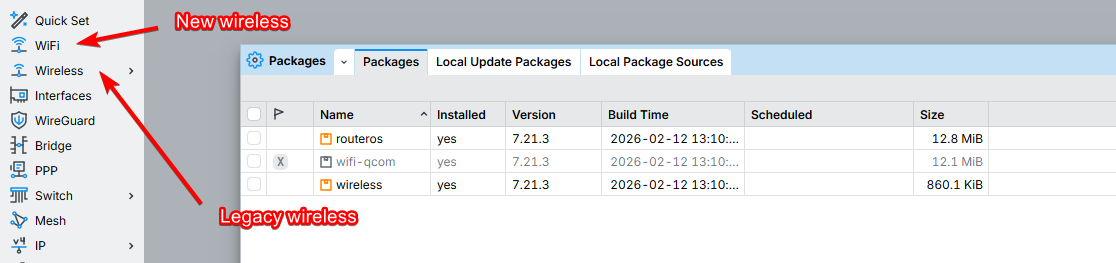

Indeed… only realised this during testing. Client RB4011iGS has gone from v6 to v7 update and has both “WiFi” and “Wireless” options with their separate CAPsMAN configurations - but only RouterOS and Wireless packages, no hint of wifi-qcom.
I know we’ve been through this all before but IMO they could have been named better like “Wireless (legacy)” and “Wireless (new)”. Okay to change WinBox but scripting is kind of stuck now. Will become less of a problem over time as the older kit is retired.
