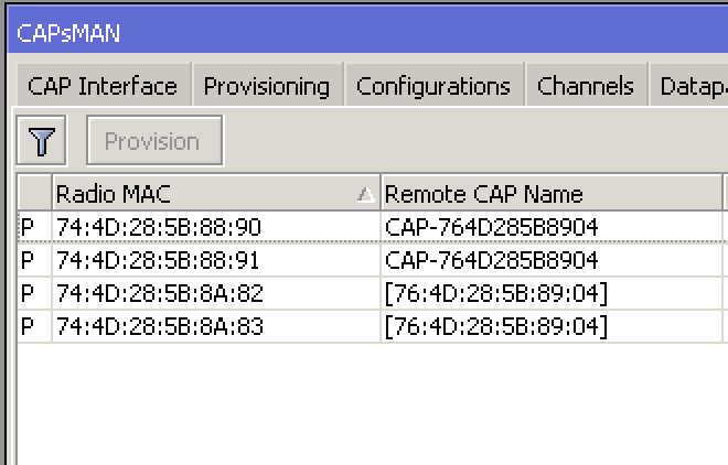

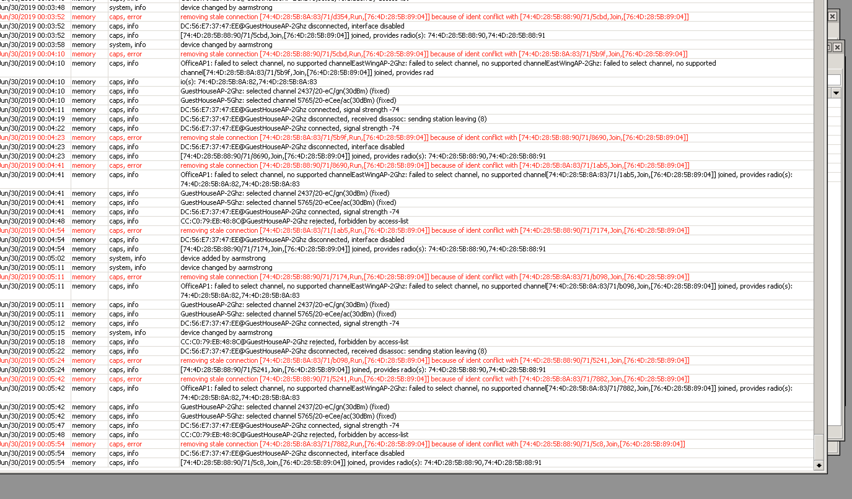

More problem, the cAPS keep dropping off. See screenshot

Have you restored configuration from another device, that you get mac conflict? If yes please you need to do MAC reset of interface
Log mentions “ident collision” wich I assume is result of non-unique MAC addresses. As I wrote: recolve MAC conflicts and after that restart all involved devices (capsMan and cAPs).

The 3rd will not connect, or keeps dropping off due to ‘ident conflict’. Mac Addresses are different. However, the WLAN interfaces appear to be identical to that of the bridged interface they’re associated with…??

all three(3) CAPS appear to connect with “CAP-764D285B8904” for name & common name.
