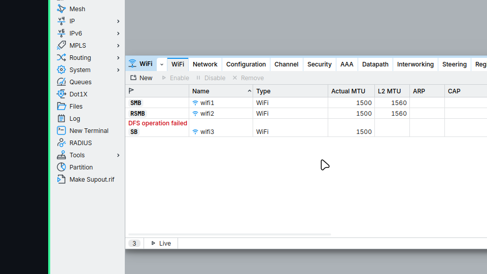

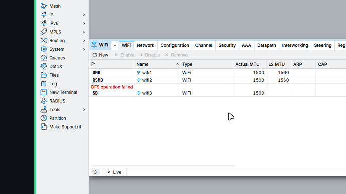

In the end, i'm trying to do this to keep the 5GHz channel:
Question: what does the "DFS channel failed" mean?
