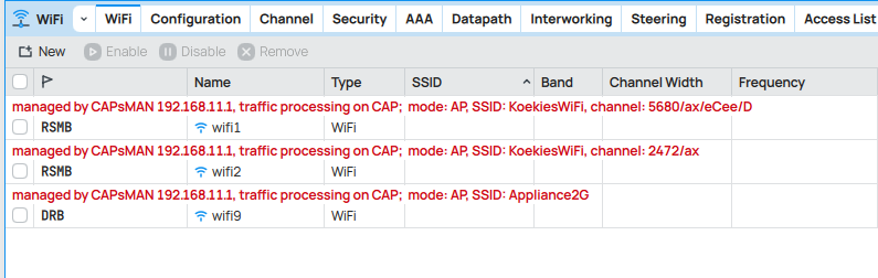

I made the change, but still it does not create the extra virtual SSID

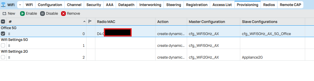

this is what my Provisioning order looks like from a visual perspective.
Provisioning ID 0 & 1 works 100%, but ID-2, dedicated to only deploy to a specific IP does not deploy
If you want multiple SSID’s on an interface, you have to use “slave-configurations” besides “master-configuration” which is mandatory.
From the CAPsMAN documentation (https://help.mikrotik.com/docs/spaces/ROS/pages/224559120/WiFi#WiFi-CAPsMAN-CAPsimpleconfigurationexample:):

Ok got it to work, but don’t know if this is a bug or I’m using CAPsMAN wrong. This is what I have done
1.)Added a master config and slave to the cAP ax provisioning record
2.)Removed the specific IP for the specific device and added the Radio Mac of the device. If I use the IP of the Device nothing happens. I sit with this problem the virtual SSID to the 5G does not deploy, but when I delete the IP and capture the Mac then it works
So my next question is, is this a bug or am I understaniding the Address Ranges function incorrecty
Address ranges only work when you set the cap device itself to search for controller using IP address.
If you let them find controller on their own, it will be using MAC.
And then those address ranges will not work.
Personally I always use MAC address to provision. Then I am sure about the radio as well.
Thank you. Yes Radio do make more sence as IP can easily be canged as well
