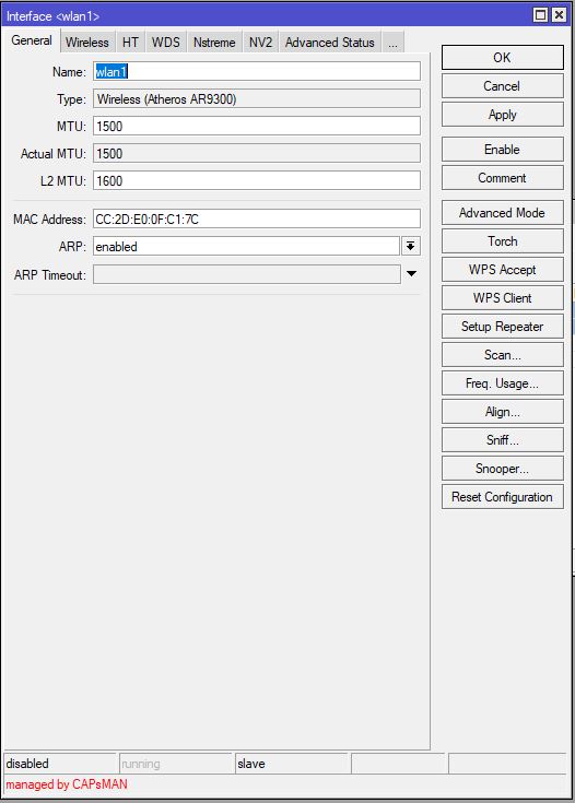

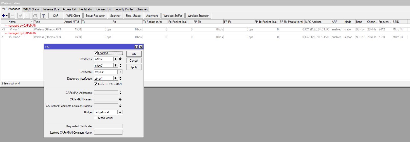

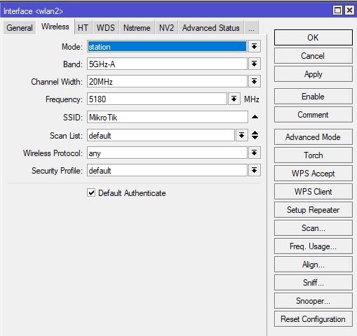

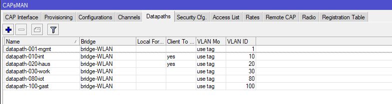

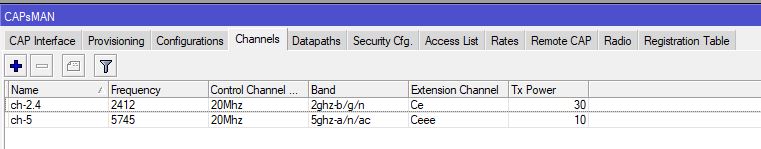

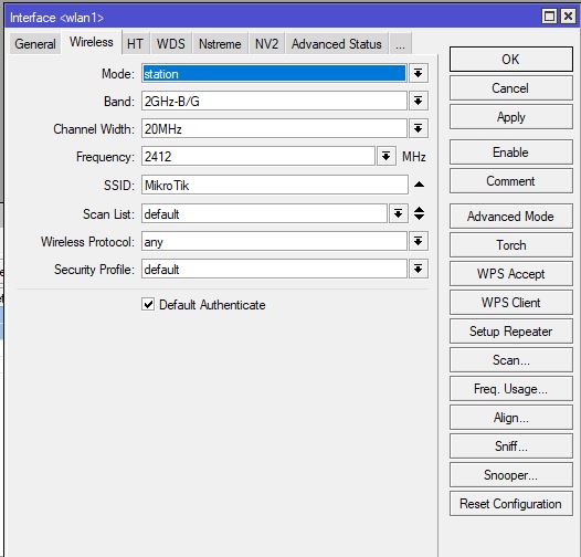

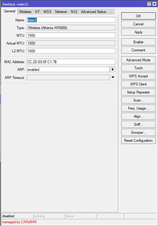

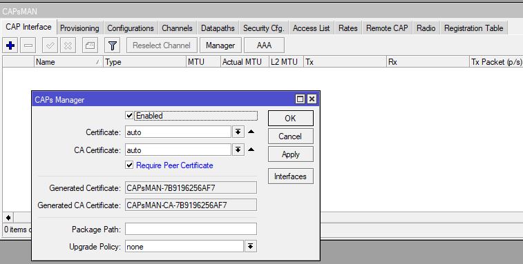

I have bought a RB3011 and two wAP ac. Now I am trying to get CAPsMAN to work. But I still have problems to get it up running. The CAPs are not shown in RB3011. Hopefully someone of you guys can help me with this topic. Would be much appreciated…
Please find attached my settings for RB3011 and the CAPs.
Thanks in advance for your help.

What is “CAP” configuration on CAPs?
Do they look for capsman in the right interface?
Ant why do you have two provisions if they are identical?
thanks for your replay. Sorry for my delayed answer. After your hints, it made it to work. Thanks a lot.
