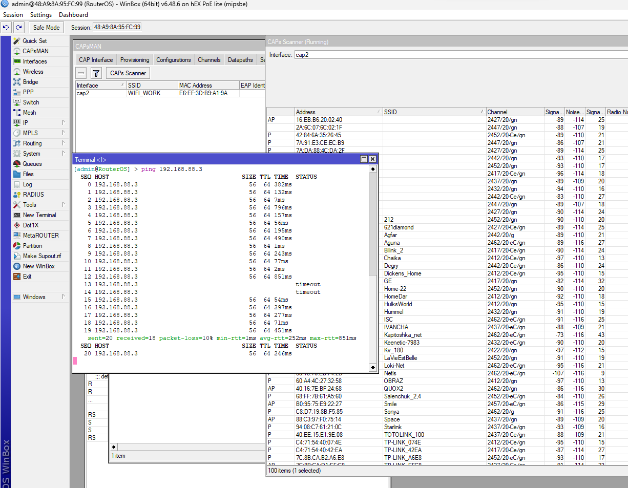

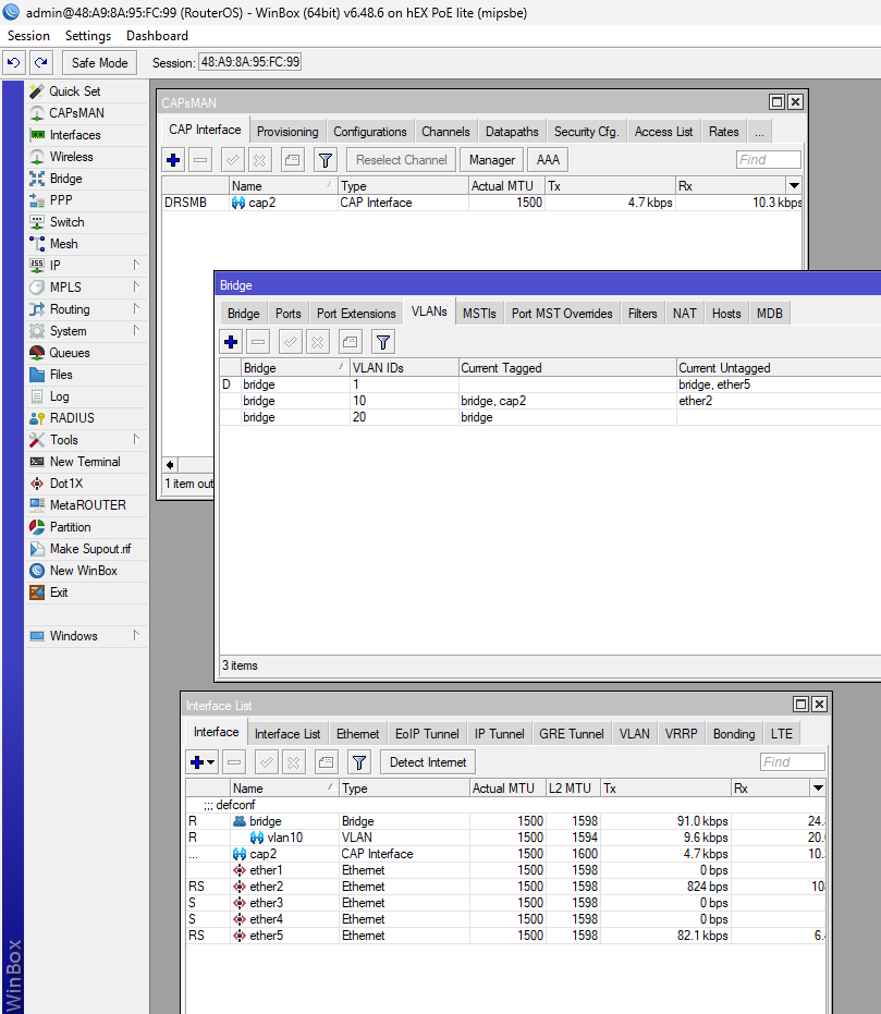

after enabling CAPsMAN, I can’t connect to my cAP RBcAP2nD for export a file…
but CAPsMAN in work, and I can connect to him from my phone, for example. And I can ping my phone from terminal of hEX PoE lite RB750UPr2)))
Now I need to friendship cAP RBcAP2nD and other devices from LAN network, that connected to hEX PoE lite RB750UPr2. And then I want to add a second cAP RBcAP2nD in configuration.
Thanks for help.

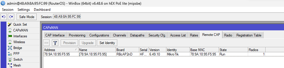

In WInbox first screen, when you got to tab Neighbours, do you see that cap device ?
It possibly got a different IP address.
You should be able to connect to it using MAC.
Hello.
No, in tab Neighbours, I don’t see the cap device
Odd. If you connect your computer to the wifi broadcasted by that cap, does it show then in Winbox ?
Another option is to connect your computer to ether2 on that cap (if possible).
