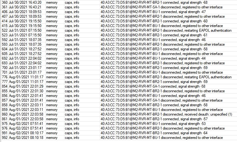

see screenshot:
zhura@10.10.201.1 (RVR-MT-MAIN) - WinBox (64bit) v6.48.3 on CHR (x86_64)_2021-08-02_08_45_00.jpg
it seemes from the log that wifi-attached notebook itself constantly changes APs. not by routeros doing something. am i wrong?
Looking at this log, the device is choosing to move between different access points. These are not errors, but just log entries showing the client roam. Roaming decisions are make by the client.
If the client was being dropped for a poor signal, the disconnect message would be different.
At least for this for device, it looks like something on the client, if they are complaining.
