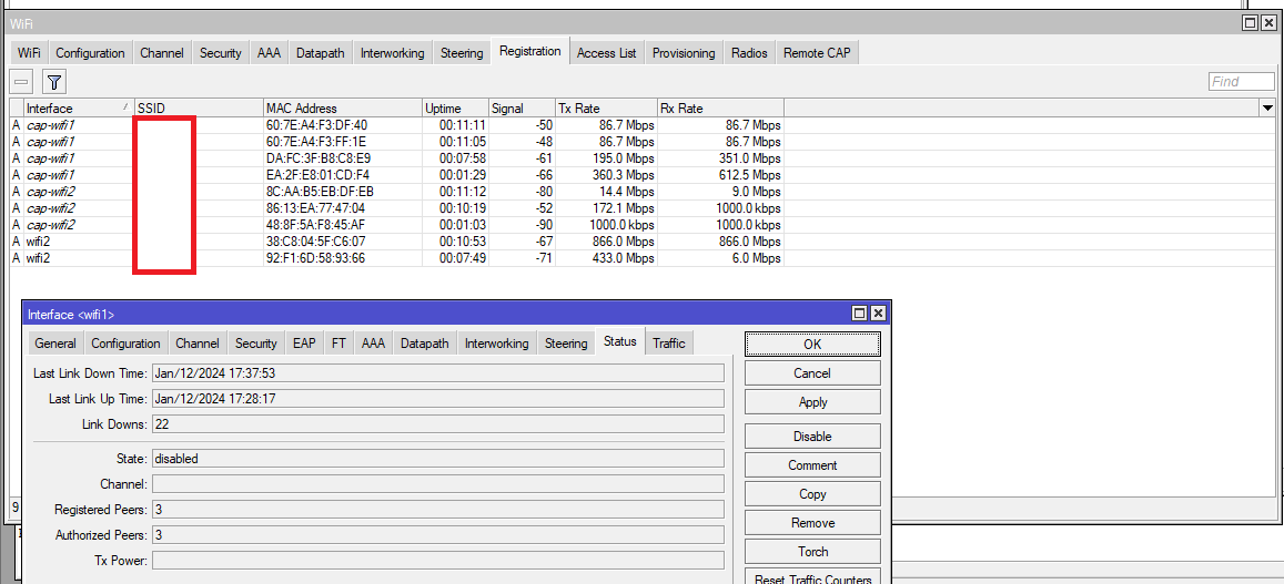

Hi
I am running hap ac3 as main router, and have hap ax2 as device for wlan coverage
Capsman is running on hap ac3, and have have successfully provisioned hap ax2 interfaces without any issues.
But i have issue when i want to add local interfaces from hap ac3 into local capsman.
First thing i was try to set on local wifi interface is on /interface/wifi/ wifi1 and wifi2 manger=capsman or local, but after i do that in winbox see that device is managed by capsman as comment but for some reason devices are not connected back to the radios.
Second thing that was try to set on existing (already working profile for local interfaces) datapath and bridge but it is same situation.
Interesting thing is that i see MAC address of local interface in /interface/wifi/radios/ but for some reason traffic is not fowarding over that interface.
On that hap ac3 i have setuped up address for CapsManManger 127.0.0.1 and have firewall rules that allows traffic.
