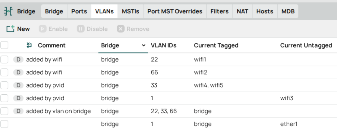

I’m new to CAPsMAN. Running AX3 for few years. I use the router as L2 switch and wifi AP (IP forwarding is disabled), no firewalls, L3 routing etc. I decided to buy cAP AX to improve wifi signal. I followed the manual WiFi - RouterOS - MikroTik Documentation (I hope).
I have 4 VLANs, actually VLAN 1 is untagged everywhere, it’s main VLAN and is used for management as well. Other 3 VLANs are tagged on ethernet (except ethernet access ports, of course).
About CAPsMAN device (ax3): When I enabled datapath configurations, devices stayed connected to wifi but everything on wifi stopped working except devices on VLAN 1 (untagged everywhere). I didn’t see anything suspicious in the configuration. When I disabled datapath, wifi works on all VLANs.
OK, let’s continue to configuration CAP. CAP deployed all wifi AP’s as expected, but nothing works (again, except VLAN 1, untagged everywhere) Bridge on CAP became configured to tag all traffic on WIFI (except VLAN 1).
CAPsMAN config:

I spent few days to get this working, but no success. Any help welcome, thanks.

Thanks, I thought print is readable better. I cleaned the configuration, tried to learn more, but no success/no change.Also tried to to change the bridge as untagged member of VLAN1 - no change.AX3, the device with CAPsMAN, works well when all datapath are disabled. Doesn’t matter if CAP is connected or not or CAPsMAN itself is enabled or disabled.
About VLANs on CAP - in the Mikrotik’s example in Confluence no VLANs are defined on CAP. This is why I’ve VLANs defined, but disabled.

I think why wifi stopps working for all VLANs except VLAN1 on CAPsMAN device should be solved first. Maybe became tagged similar to CAP?
Thanks for help.
I spent lot of hourts trying to enable datapath and not stop wifi working. CAP device turned off, I’ve in datapath just name, bridge and vlan-id, nothing else. Datapath shouldn’t affect wifi on CAPsMAN device, right? But it does. Or it’s not possible to have AP’s on CAPsMAN device itself and on CAP at the sane time?
I’m going to give it up :frowning:
It’s resolved. I’ve to say big thanks to Google AI - the root cause is AX device. AX devices handle VLAN tags on wifi interfaces in the driver (chipset, unsure). It means wifi interfaces on AX capsman should be added as tagged bridge ports. When a VLAN is is in datapath, the driver’s behaviour will change.
