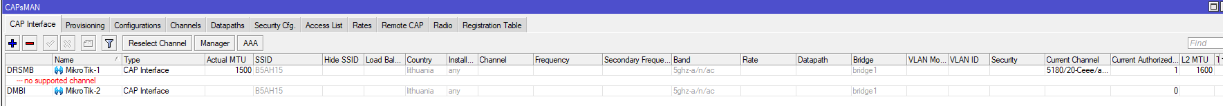

I have successfully configured 5Ghz radio, but get “no supported channel” for 2.4Ghz

What I have noticed, that interface is using provisioning of 5g config
What am I doing wrong?
If you set the hw-supported-modes on the provision rule, the correct config is provisioned to the radio. Especially because you have a distinction in channels. Something like:
/caps-man provisioning
add action=create-dynamic-enabled hw-supported-modes=ac master-configuration=cfg-5g name-format=identity
add action=create-dynamic-enabled hw-supported-modes=gn master-configuration=cfg-2g name-format=identity

Added hw-supported-modes and this corrected “no supported channel”

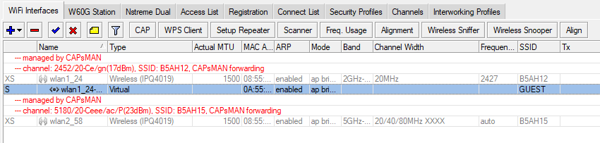

I have a virtual “GUEST” interface which is not supported when I add it as CAP.
And as it is a sub for CAPsMAN controlled interface - it is no more available
Where do I start digging?
Guest network can be added by using a slave (besides the master) config in CAPsMAN (no need to change the CAP):
https://help.mikrotik.com/docs/spaces/ROS/pages/1409149/AP+Controller+CAPsMAN#APController(CAPsMAN)-Basicconfigurationwithmasterandslaveinterface
thanks once again
it is working, but is it correct?
I have set the guest config as slave to both provisioning rules, what I expect is that GUEST is for client to decide the frequency

This is correct. You don’t have to set vlan-id on the datapath. Unless you want to work with VLAN’s, but then there is a lot more to change.
Clients do (indeed) decide to which band (either 2.4GHz or 5GHz) they connect. Frequency is handled by the CAP (when scanning for the best available and could be set by the CAPsMAN).
