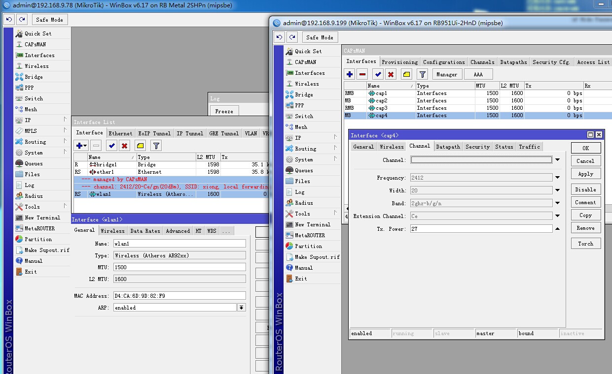

if set 17dbm is ok.if set 27dbm,30dbm,32dbm all can’t.
this wire card can work on 32dbm.but in capsman can’t.

hi, I set superchannel with CapsMan??
the option does not exist in capsman!!!

That doesn’t work for me in 5 GHz
Looks like the limit is got from “no_country_set” domain. It allows up to 30 dBm got 2GHz, and only up to 17 dBm for 5 GHz.
Does anybody know how to increase tx-power limit for 5 GHz with CAPsMAN? It’s in controlled isolated environment ![]()
