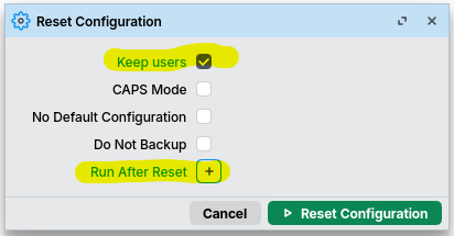

That’s probably where I would start testing. Edit this as needed, save as an .rsc file. Upload the file to the wAP and reset it with the option selected to keep users, and run the uploaded .rsc after reset (options highlighted below).
You will have several possible outcomes:
  • Full success. wAP gets an IP from router, and broadcasts the SSID on 5GHz.
  • Partial success. wAP either has an IP but doesn’t broadcast, or vice versa.
  • Error in reset. If the wAP doesn’t get an IP at all the reset script may have failed. Try wiring to it and connect via MAC if possible and check the log for an error during reset.
