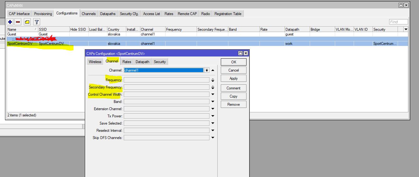

But i have quescion, how I set diferent freqenci on 3 devices ?
Becouse, I can change freqenci on primary Mikrotik, but I can not change freqenci on sec. devices. Becouse, they are controling primary mikrotik .
Sorry for quescion , i am beginner.
I have on primary microtik diferent freqenci , but on all devices i have only one freqenci why ? How I set diferent frequenci on for diferent device ?
The AP MAIN RADIO lets you set the channel.
The Virtual interfaces follow that channel.
Hello, you need to do your changes on your CAPsMAN, not CAP.
Wrong, when using multiple accesspoints within a network you want to have all settings identical except the channels .
If you want to have network seperation, you can use VLAN:

Create provisioning rule per radio. Add radio mac to make it radio specific. That’s it.
Make 3 provisioning rules.
Each of the rules using a different channel, all the rest stays the same.
Assign one rule (each time a different one) to the mac address of the radio where you want to have that channel being used.

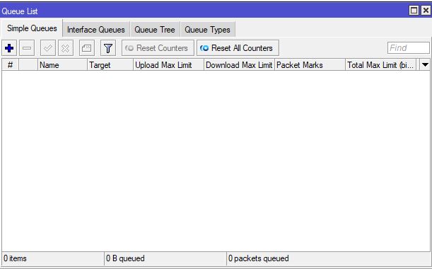

But I have problem no. 2 .
Wifi now is stabil but i have UP/dows 8Mbit/. I hed Queue option on 8 Mbit/s .
Now I deleted this queue and I have speed 8 Mbit/s , why ? I deleted queue .

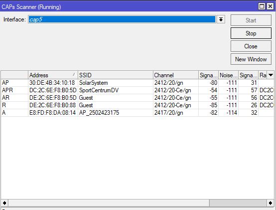

1 X radio-mac=DC:2C:6E:F8:B0:88 hw-supported-modes="" identity-regexp=""
common-name-regexp="" ip-address-ranges="" action=create-dynamic-enabled
master-configuration=app1-ch1-cfg slave-configurations=Guest_ch1-cfg
name-format=cap name-prefix=""
2 X radio-mac=DC:2C:6E:F8:B0:5D hw-supported-modes="" identity-regexp=""
master-configuration=app2-ch6-cfg slave-configurations=Guest_ch6-cfg
3 X radio-mac=DC:2C:6E:F8:B0:21 hw-supported-modes="" identity-regexp=""
master-configuration=app3-ch11-cfg slave-configurations=Guest_ch11-cfg
This is me config. It is bad. One radio is OK , and two radios is bad . I do not know .
