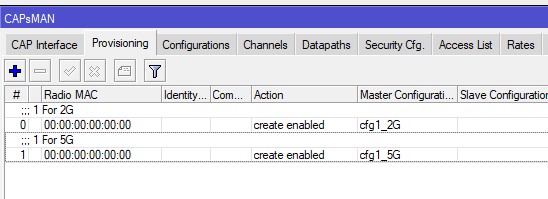

You will need two configs.
And based on e.g. MAC address of the radio, apply the correct config in provisioning.
And when you think about it, it’s logical. 2.4GHz settings are not the same as 5GHz settings.

For provisioning I’ll use the hw-supported-mode option to select which radio gets a 2GHz or 5GHz config.
/caps-man provisioning
add action=create-dynamic-enabled hw-supported-modes=ac master-configuration=\
    5G-Config name-format=prefix-identity name-prefix=5G slave-configurations=\
    5G-Slave
add action=create-dynamic-enabled hw-supported-modes=b master-configuration=\
    2G-Config name-format=prefix-identity name-prefix=2G slave-configurations=\
    2G-Slave
