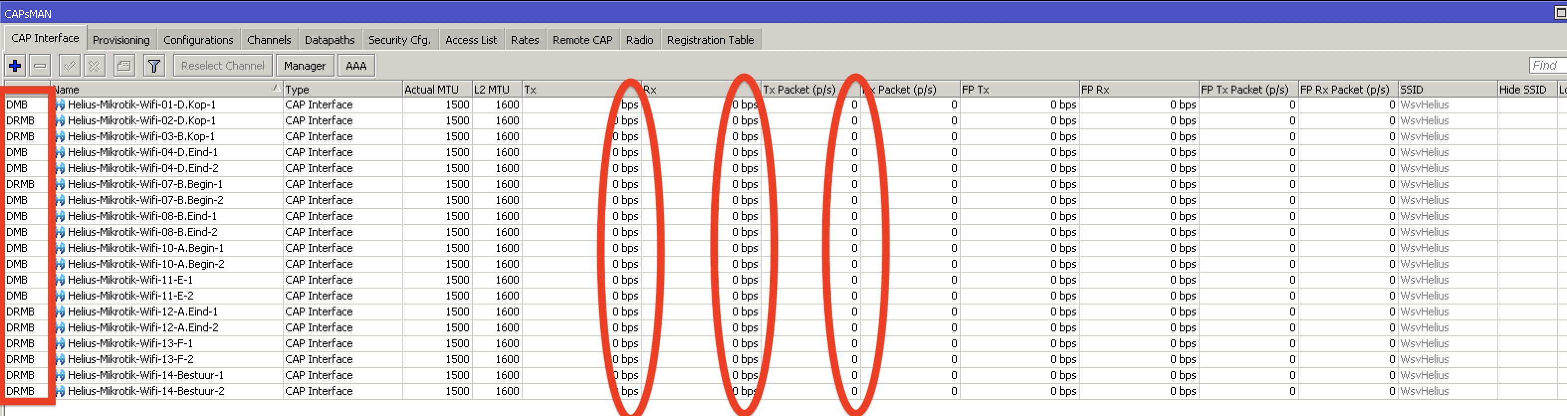

On the CAPsMan interface tab page, the first column, there are the characters DRMB, I know that I can find the abbreviation in the footer of the window that you get when double clicking on one item. But my question is why do I’ve the R (= Running) with some of them and not with the others? Is this because of the fact somebody is connected to the AP? Then the R shows up? Can somebody explain?
Second question, why are the Tx/Rx/etc numbers all 0? Is that because I’m using local forwarding so that not all the traffic goes through the CAPsMan device?
Third question, why is the SSID in light grey color? has that a special meaning?

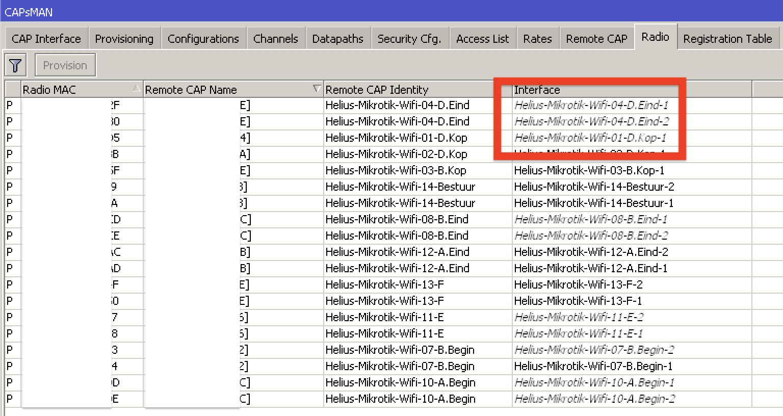

Fourth question, in the Radio tab page, why are a number of my interfaces in grey italic font? Has this a special meaning? Is this because there is no client connected to this AP/Interface?

I guess it’s same as with ‘real’ wireless interfaces (if they are not provisioned by CAPsMAN): they are marked as running only if there’s at least one wireless client connected.
I guess that’s likely explanation.
Genrally when clicking a row, configuration window opens. I guess greyed settings can not be changed in this configuration window as they are set elsewhere. SSID in particular is likely set in Configurations. And if you pan the columns left, there will be additional columns on the right side, most of them greyed out due to same reason.
Winbox (and webfig) have this nice feature where configurations from different subtrees together with running values get shown together, making things a tad easier to monitor/configure. In CLI this doesn’t happen which makes things more straight-forward but (sometimes) harder to link corresponding items.
These correspond to the “non-running” interfaces.

As I commented on your first question: status of an interface is “not running” if there’s no connection through it. While with wired interfaces this is pretty much clear, with wireless it is not at first thought. However, one should not think that “not running” is synonymous to “down” or “disabled” or “undefined”. Wireless connection is “disabled” if its property says so. According to my experience (which is little) with capsman the interface disappears from CAPsMAN if connection between CAPsMAN and CAP breaks (unless action=create-enabled under /caps-man provisioning).
Thanks for the (extra) clarification. This matches when I check the Registration Table to see which AP’s have clients connected, those are not grey/italic. The ones that do not have clients connected are indeed grey/italic. Thanks.
