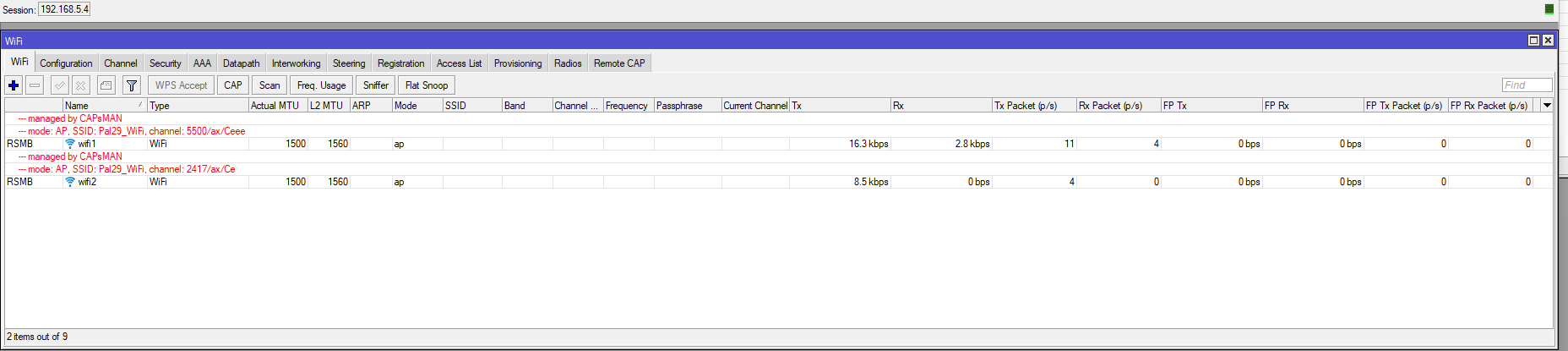

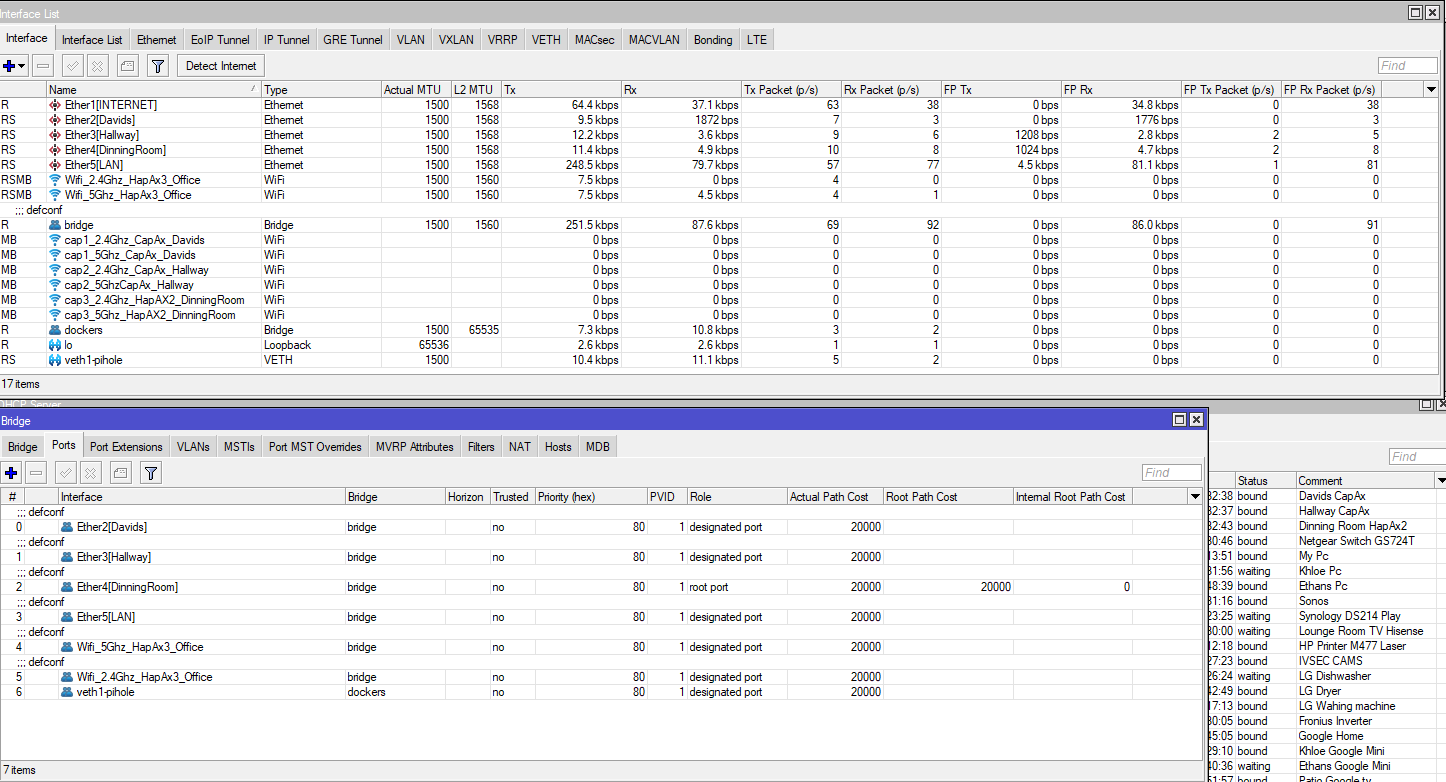

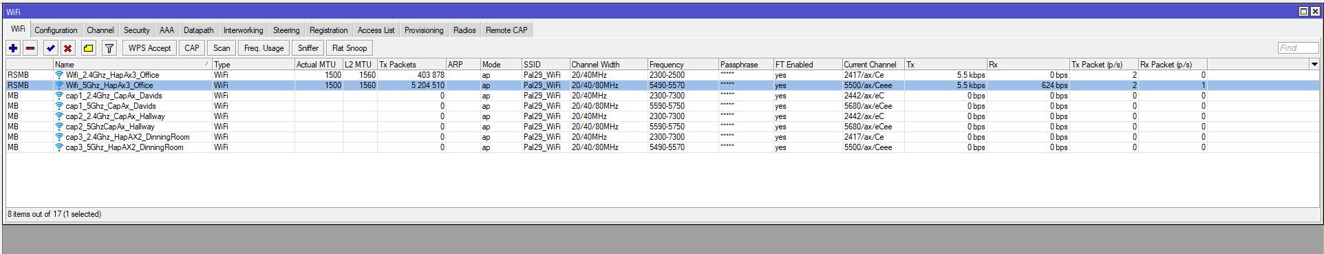

In the hapax3 I look at the wifi I can see all the ap there all connected and working they have a MB beside the names but I can’t see any traffic flowing threw them in the tx/rx like I can see on the hapax3 in the same section??
am I missing something or is that how it is??
i can log into the Capax individually I can see the tx/rx from there but I thought CAPsMAN was the central position to see all this.
just want to see which AP is getting used and by who and what bandwidth and speeds are like the interface list but in the wifi section

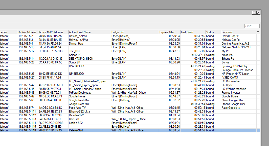

in the DHCP server lease, I can see who is connected to what AP but still not what I’m after

https://help.mikrotik.com/docs/display/ROS/WiFi#WiFi-WiFiCAPsMAN
WiFi CAPsMAN can only control WiFi interfaces, and WiFi CAPs can join only WiFi CAPsMAN, similarly, regular CAPsMAN only supports non-WiFi caps.
The CAPs don’t send traffic usage information to CAPsMAN.
You get most of this info on the “Registration” tab.
