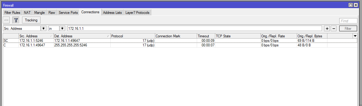

I can see the connection on /ip firewall connections, but it still is unable to connect/provision.

As you can see on the attached image, the connection is estabilished, but for some reason it’s not provisioned
