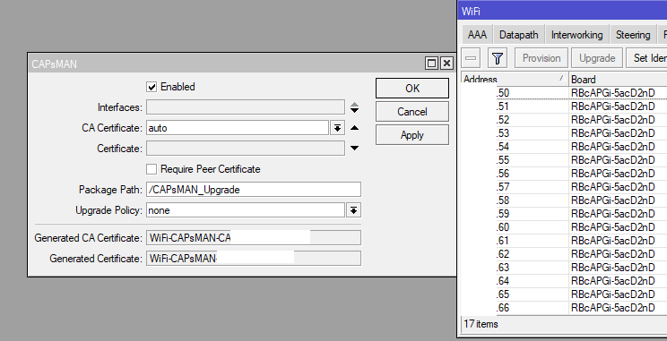

In my CAPsMAN config I have selected an interface. This is the only difference.
/interface wifi capsman
set enabled=yes interfaces=vlan1001 upgrade-policy=suggest-same-version
I tried this before via internet but found the same result.
Hope this can be fixed.
Sorry, I read incorrectly
SOLUTION was to unset interfaces in /interface/wifi/capsman. Having
/interface/wifi/capsman set interfaces=""
it works.
