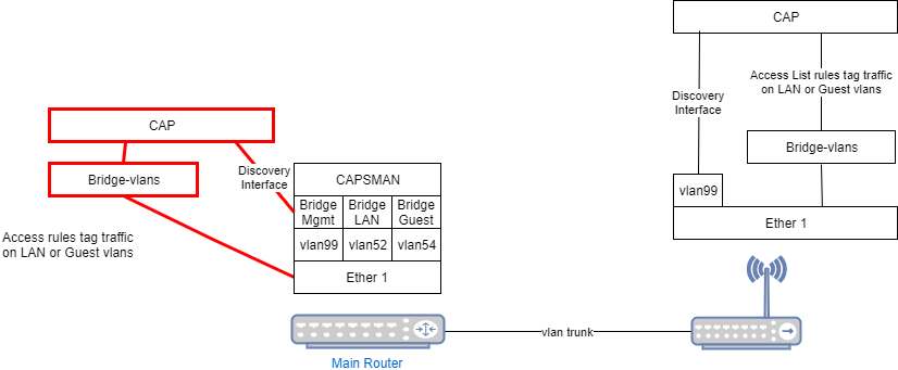

Hopefully a diagram will help.
Here’s what I’ve configured. The portion in black and the remote CAPS work perfectly. The red shows what I am trying to do on my main router. I also tried attaching the CAP on the main router to ether 2, but that did not work either.
Any help much appreciated. Thanks!

You need to move the Vlan inferface from the ether1 to the bridge interface as that ether1 interface is a part of the bridge interface.
Hi Uldis, thanks for the reply. Would you mind clarifying please? Do you mean add a bridge port to “Bridge-vlans” on the main router to one of the vlans instead of directly to ether 1?
If I do that, then which vlan do I use? I am changing the vlan in an CAPS access list rule like this

I’m not Uldis, but I think what he’s saying is that, you create a vlan interface, and add that to the bridge, a native bridge. I ran into this when creating a guest wifi over trunk ports.
So, my understanding is that you need at least two bridges, both with different IP schemes assigned to them. One bridge is for untagged, and the other for tagged (or however you want). Then you’ll create a VLAN interface assigned to a physical port, then you add the physical port as a member of the vlan bridge, and the vlan interface itself should be a member of the native bridge. See my example in the link.
I am wringin about this part below. I suggest to put vlan not on the ether1 but on the Bridge-vlan1.
add bridge=Bridge-vlans interface=ether1
/interface vlan
add interface=ether1 name="vlan99-Management" vlan-id=99
Hi Uldis, I am sorry I am not clear - I think your reply says to change the configuration on the remote CAP. However, the remote CAP works fine. My devices will be put on the correct vlan according to the access list rule.

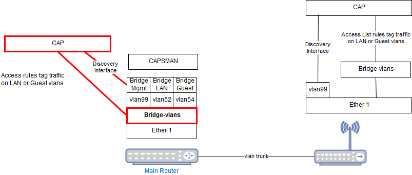

My question is how to get the radios in the main router which also runs CAPSMAN to use the same CAPSMAN profiles?
Are you suggesting this configuration shown in red? This has the Bridge directly on Ether1, and then the VLANS and the CAP above it.

I tried configuring as per my revised diagram, and everything now works.
Thanks for the pointer Uldis and PCunite.
