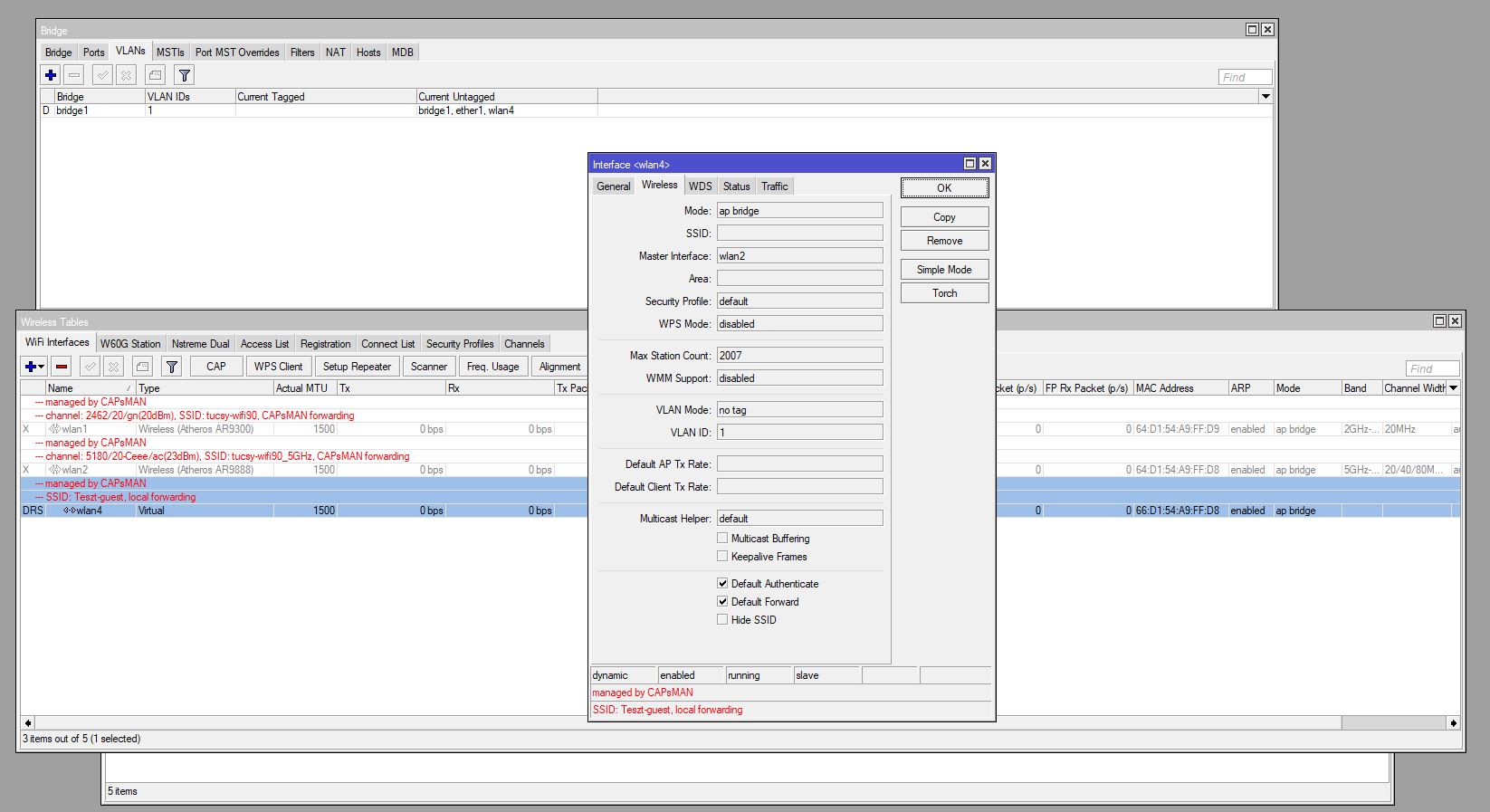

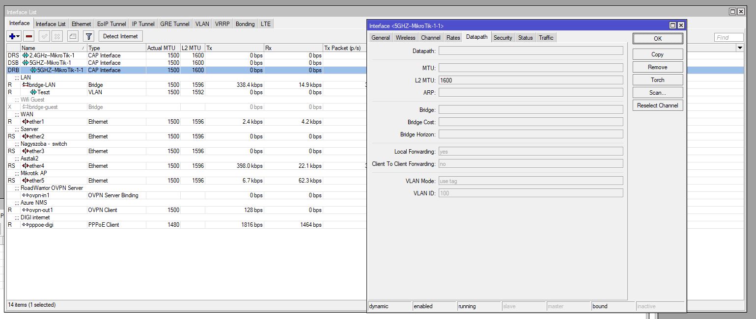

I would like to ask some help because I’m really confused.
I tried to make some VLANs and SSIDs in Mikrotik devices (router and AP with CAPsMAN).
In CAPsMAN I set VLAN mode to “use tag” and VLAN ID to “100” but on the AP I see “no tag” and VLAN 1.
I attached two sreenshots too.
Does anyone have an idea of what’s wrong?
Does someone have any idea? :slight_smile:
Your check is wrong :slight_smile:. When a wireless interface on a MikroTik is managed by CAPsMAN, the interface is not showing you the running settings. They can be seen on the CAPsMAN on the interface, only there.
Thanks. :smiley: :slight_smile:
