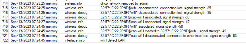

The problem is that switching the client from hap ax2 to hap ac3 does not work.
Case
  1. The client connected to hap ax2 goes towards hap ac3
  2. The signal strength is -90, while the client is already standing near hap ac3 with a -50 signal
  3. Wifi on the client is disconnected, reconnected already to hap ac3
  4. The client goes back to hap ax2 - history repeats itself
I saw the following entries in the logs
with cap-wifi1 (ac3) there is roaming on wifi1 (ax2)
with wifi1 (ax2) on cap-wifi1 (ac3) there is no roaming (

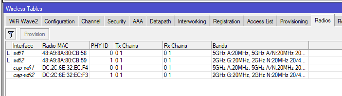

Not clear how your config is like ?
You have a combination of local and capsman radios ? Which one is capsman controller ?
CAPsMAN ax2

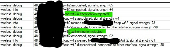

Hello, I am having a similar problem and I am looking for a solution with the support team.
When you enable wireless debug in the logging section, will “authentication rejected” appear in the logs when an error occurs? We may be experiencing the same problem.
For logging:
/system logging
add disabled=no topics=wireless,debug
Hello! Added logging according to your sample. But there are no entries in the logs with authentication problems.

@İmposss
authentication rejected means what it says.
There is something wrong with authentication for that device/radio.
Please create new thread and post your problem and config there.

Hello, today we decided with the support team that the problem occurred because the device causing the problem does not support the IEEE Std 802.11‐2020 standard. The device I mentioned has Android 9 version and received the last update in 2019.
