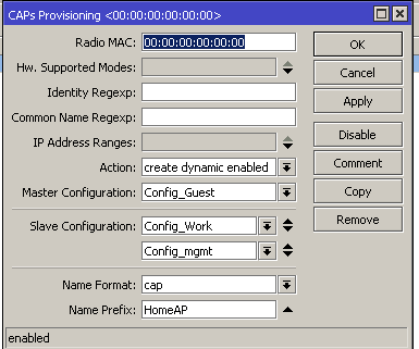

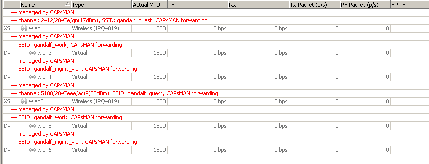

I am currently facing issues with capsman.
I am provisioning configuration to caps, however on caps I see all wifi interfaces in disabled state.
Output from cap
Output from Capsman
Thanks for advice.

That can really be misledaing.
So see the actual managed interfaces, you need to look at your caps manager.
The output of the managed CAP is just an indication that you can’t do anything there b/c it is managed by CAPsMAN.
-Chris
hm, weired, looks like I found the issue.
I had to ad WAN interface to LAN, and it is working now.
AP is provisioning from main router, but interfaces are still showing as disabled.
Dont understand this, but since it is working I am happy for that.
