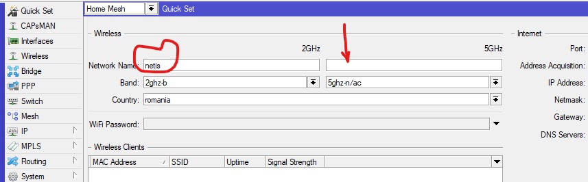

Newbie here, using RB2011UiAS-2HnD with two CAP ac AP’s.
I would like to let clients connect automatically to 2 or 5GHz networks but it looks like my 5GHz network does not have a name.
Should I use the same SSID name as for 2 GHz network has, in my case netis?
Or is it mandatory to use a different SSID’s?
No it is not mandatory, but in practice its better to use different SSIDs…
If they have the same name and you have a device that supports both 2.4 and 5GHz bands you will see twice the same name “netis”…
So which one is the 2.4 and which the 5 GHz ?

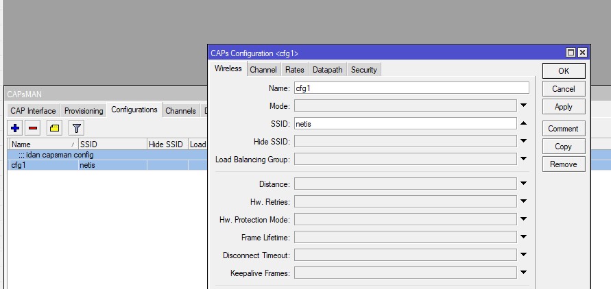

Thank you for the answer!
But how to deal with two different SSID’s in CAPs Configuration?
Define a new config? How?
Ofcorse, you need a totally new configuration for the 5GHz band…
Then you create a second provision rule for the 5GHz wireless interface and you assign the newly created config…
