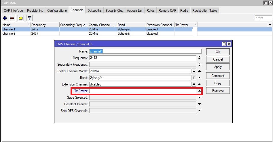

I am need to active capsman inside of building so whats the TX power should i set in capsman**“channels configuration”** because the signal strength depend on TX power?
You don’t need to put anything in there, the max allowed is used by default.

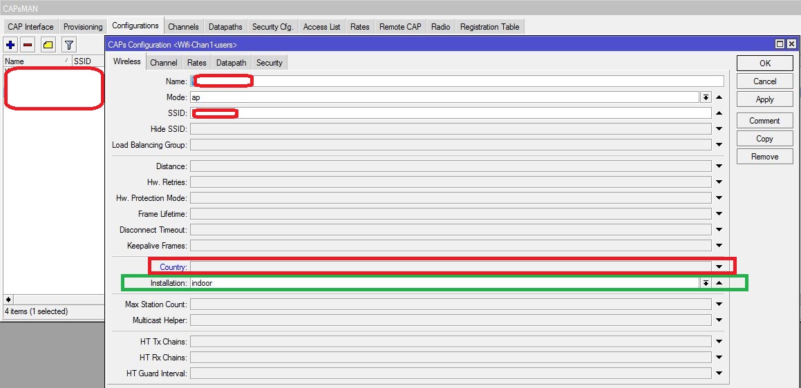

If under Capsman → Configurations → Wireless you did set your Country (as you should) then the Tx Power will be the maximum allowed for you Country…
Only in case you want to lower the Tx Power you do use the Tx Power paramater field…

My tested putting the TX power in channel of capsman server = 20 its good one the signal strength best of when using -10 for example!
In my cause my country Not Found with list, So i selected the Installation “indoor”
And if set in channels of capsman
I think if set to +20 maybe good, And if set empty maybe not good because signal is reduced, How i know the Maximum of TX power of mikrotik devices?
Your question is already answered…
If you leave the Tx Power empty, the MAX allowed by interface is used…!
However, you must use the Tx Power allowed in your Country… That is why we select the Country…
Those two (country and installation type) are complementary, meaning that installation type does not work at all without country being specified. I guess when running your AP without CAPsMAN your obvious choice was “no_country_set”. That setting (while illegal in many parts of the world) does allow you to use whatever frequencies and TX power your hardware is capable of. This option, however, is not available for CAPsMAN, and so when no country is specified CAPsMAN will enforce a rather conservative limitations. The best thing you can do is to specify some other country whose regulations are the same or very close to what’s allowed in your own country.
Therefore, I did not know what is the correct value chosen because my country is not in the list, and now I will leave TX power it blank to work MAX allowed by interface as per your note ,

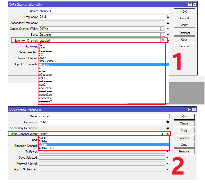

Whats the true select if i need to enable those “1 and 2” ?
Extension channel
Control channel width
Set control channel width to 20Mhz and extention channel either disabled, in case you only want to use 20Mhz as channel width, or Ce, eC, XX in case you want to support 40 Mhz channel width as well…
Thank you, After tested when i selected the 40 Mhz and tried Ce, eC, XX but in log show failed to select and tried to change the frequency to 2462 or 2457 the same not worked!, Maybe working on 20Mhz so my cap its RB 951 2n , And the CapSman RB 2011 Uias 2h…
I am tried to set “no_country_set” and “Indoor” but the same Signal strength, And tried to select country maybe Close to my country the same, I tried without set anythink and empty and in channels of capsman the TX power empty maybe It could be better, Or set the TX power equal 17 and without in configuration that mean no “country and indoor” could be better also.
Be carefull with the frequencies. The selected channels are 20 MHz wide, the frequency slots are 5 MHz wide. Normally you use channel 1, 6 or 11 (2412,2437,2462).for no interference.
With Ce you use double the number of 5 MHz slots, so 2412 will use 2404-2408-2412-2417-2422 for C, and 2427,2432,2437,2442,2447 for e, and that’s OK.
2462 Ce will be out of band, because the 20 Mhz e band is above the 20 Mhz C band at 2462. Even “2457 Ce” will not fit in the 2.4 GHz band. (European (ETSI) countries are allowed up to channel 13, but even that’s not enough. No_country is limited to channel 11). 2412 eC is not possible for the same reason.

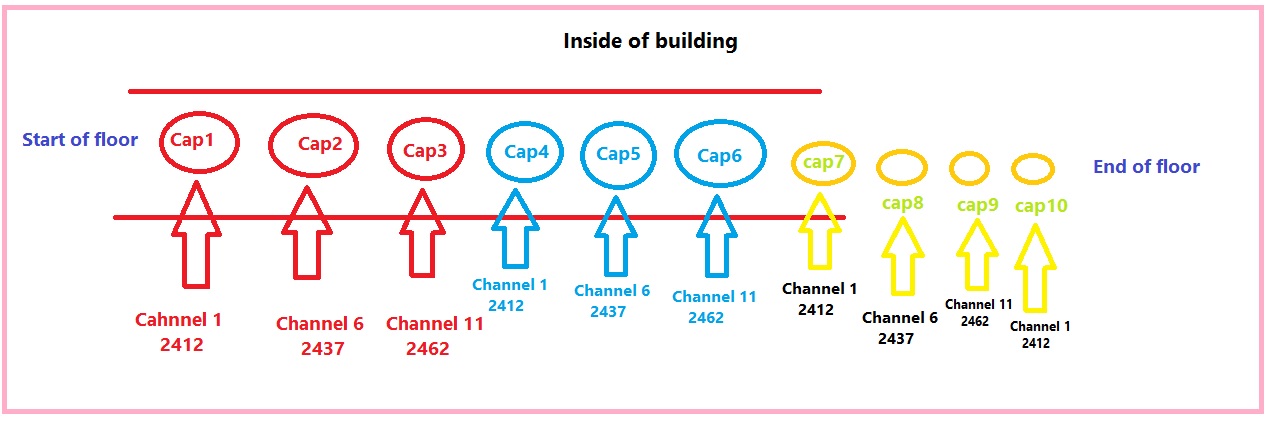

Normally I am used channel 1, 6 or 11 (2412,2437,2462), My notes here if have for example 30 Ap as Caps. Is it permissible to re-use the frequency channel 1, 6 or 11 (2412,2437,2462) distribution for the same floor? without interference or confusion and you can see below the example of distribution “Caps”, The diagram is simple, illustrative :

My country Not available with countries so i tested to selected “no_country_set” and selected “indoor” but the same Signal strength, In this case i go to tried in Channel in capsman In order to write an appropriate value by TX power and tried equal 17 by normal maybe increase to 20, Can we say the signal got better but howerver how i know the routerboard how max. TX power can be working before damage the device? Or if i need to know How TX power it is determin to cover a specific area so that we distribute the rest of the devices “caps” in order to cover the spaces correctly?
