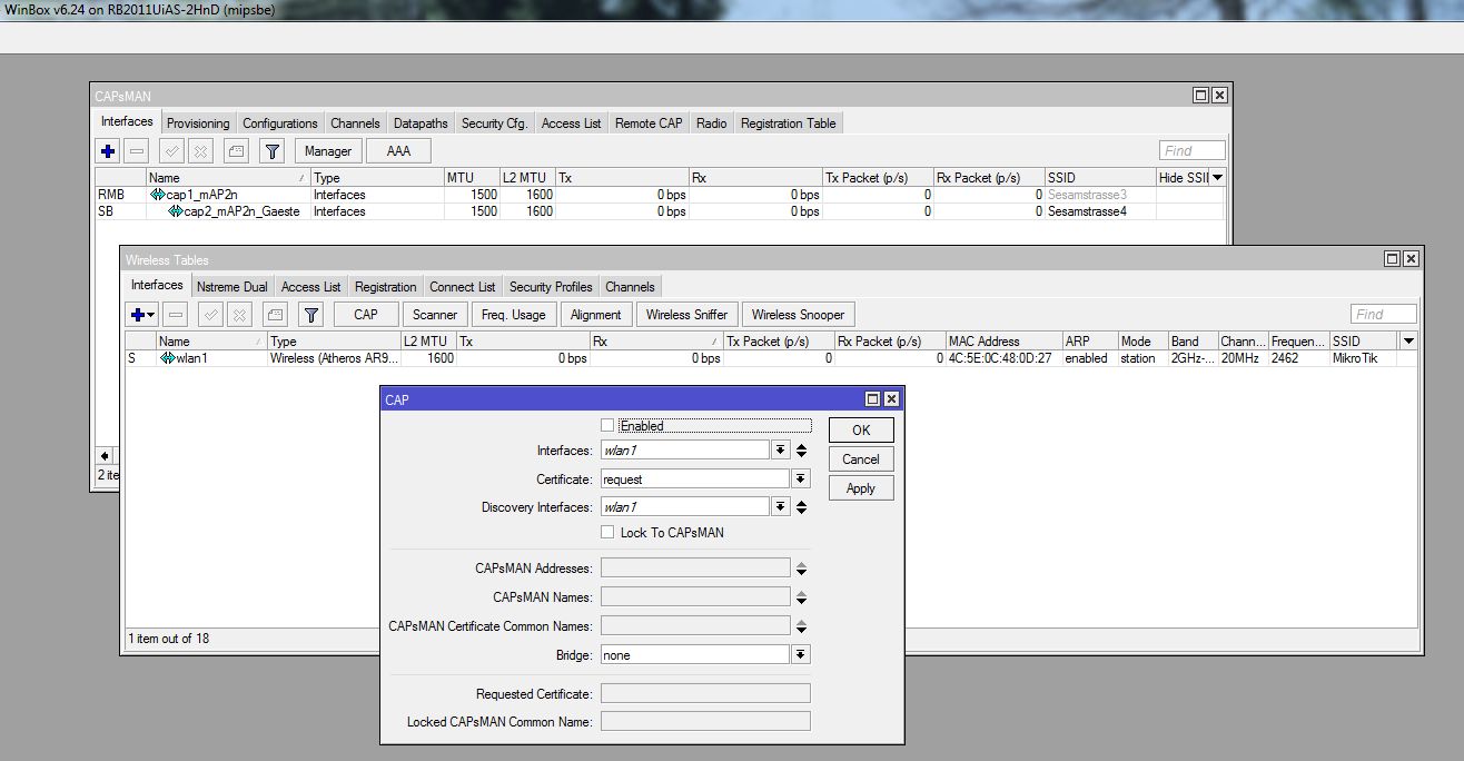

Can I include the Wireless-Radio-Interface from my Router RB2011UiAS-2HnD (shown at the screenshot as wlan1) into the CAPsMAN?
I have a Router RB2011UiAS-2nD and a Mikrotik mAP2n.
The connection between them works fine.
But now, I want use the Router-Wirelessinterface also.
Is that possiple?
yes, you can do that.
I suggest to use RouterOS v6.25 and install the Capsman v2 package on this board and map board.
