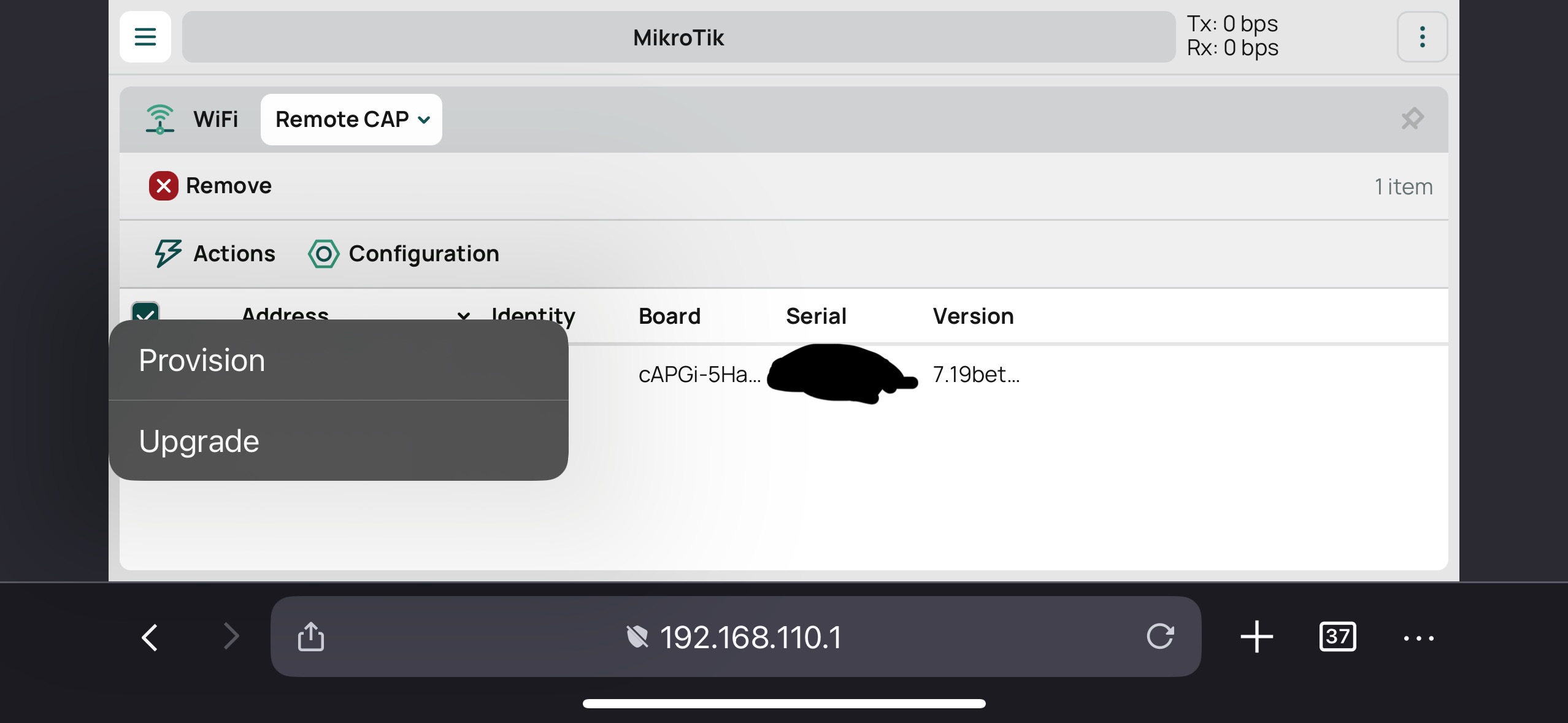

Press the provision button on CAPsMAN on the wifi - remote cap
Also check log on both CAPsMAN and CAP.

Mind you I’m on webfig via my phone but it’s under WiFi → Remote Cap
Then you select the cap you want to provision, click actions and click provision.

Prior to the “provision” cap AX wifi was showing:
(5G) managed by CAPSMAN F4:1E:57:2D:A3:2A@bridgelocal, traffic processing on CAP; mode: AP, SSID main, channel: 5885/ax/eeeC
(2G) managed by CAPSMAN F4:1E:57:2D:A3:2A@bridgelocal, traffic processing on CAP; mode: AP, SSID main, channel: 2437/ax/eC
After provision:
