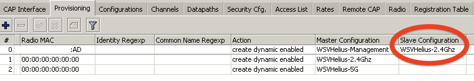

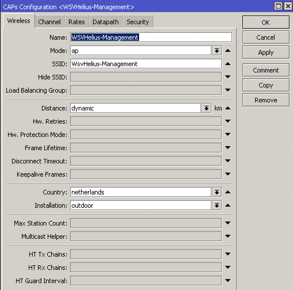

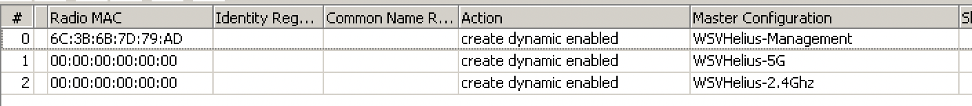

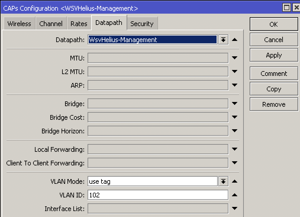

I’m back on this issue again, it was working correctly, but now for some reason it is not working anymore.
I’ve still set the slave config. I went through all the config but I cannot find the error. Any suggestions on how to resolve/debug this?

[admin@MikroTik-RB750-DudeServer] >> /caps-man provisioning print
Flags: X - disabled
 0   radio-macXX:XX:XX:XX:XX:AD hw-supported-modes=ac identity-regexp="" common-name-regexp="" ip-address-ranges="" action=create-dynamic-enabled master-configuration=WSVHelius-Management slave-configurations=WSVHelius-2.4Ghz
     name-format=identity name-prefix=""
 1   radio-mac=00:00:00:00:00:00 hw-supported-modes=gn identity-regexp="" common-name-regexp="" ip-address-ranges="" action=create-dynamic-enabled master-configuration=WSVHelius-2.4Ghz slave-configurations="" name-format=identity
     name-prefix=""
 2   radio-mac=00:00:00:00:00:00 hw-supported-modes=ac identity-regexp="" common-name-regexp="" ip-address-ranges="" action=create-dynamic-enabled master-configuration=WSVHelius-5G slave-configurations="" name-format=identity name-prefix=""

Solved the problem, found the issue. The radio configuration (the band) of the two configuration where not the same. After changing them to gn the problem was solved.
