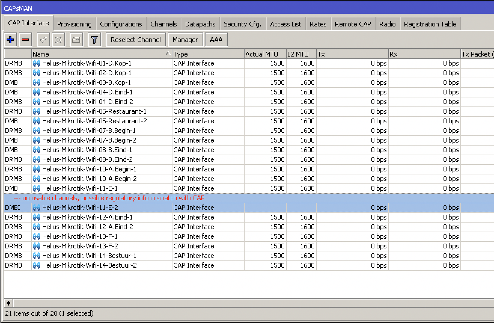

I’m having about 11 Mikrotik routers running which are managed through CAPSMann. I’m using the same CAPSMann config for the routers (2 profiles, 2.4 and 5Ghz profile). No I discovered the following error message on one of the WIFI access points:
“no usable channels, possible regulatory info mismatch with CAP”
Any suggestion what is happening? How can I resolve this?

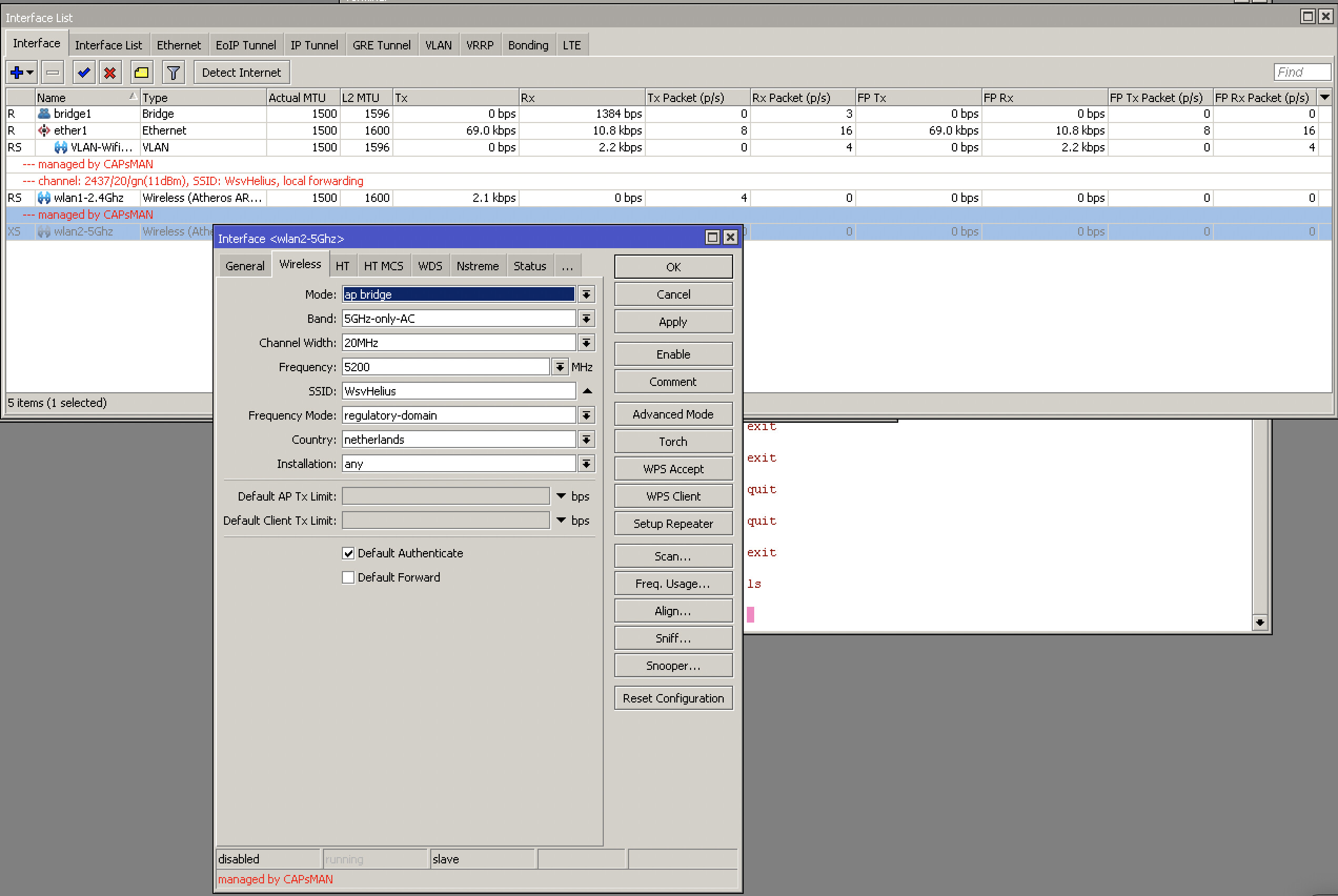

There is no country set on the AP itself as this is not possible to my understanding. As it is managed by the CAPsMan, I cannot set the country locally on the AP itself. See screenshot.

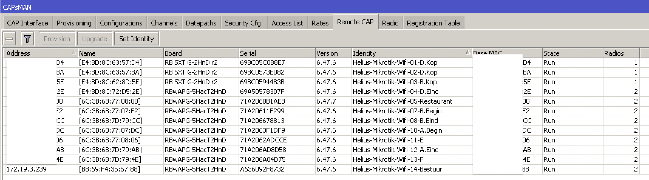

I’ve two type of Mikrotik devices on the network all running the same software (except 1 AP), see screenshot:
All the AP’s are managed through the CAPsMan, there is a 2.4Ghz and a 5Ghz profile. And all the wAP’s are managed using the same profile.

You cannot set the country locally on the cAP once its wireless interface is controlled by CAPsMAN, but you can still see the setting if you use the command line (available after pressing the [Terminal] button) command I’ve suggested. My speculation was that some other country profile than netherlands might be set on that wAP, and that it is not simply overridden by the country value requested by CAPsMAN but it must be the same unless its value is no_country_set. I’ve just checked such a hypothetic issue doesn’t exist on 6.46.8 I’m running here (the CAPsMAN setting simply overrides the local setting on the interface), but I don’t know whether it’s the same case at your 6.47.6. Some additional measure to assure regulation conformance may have been added in the meantime.
