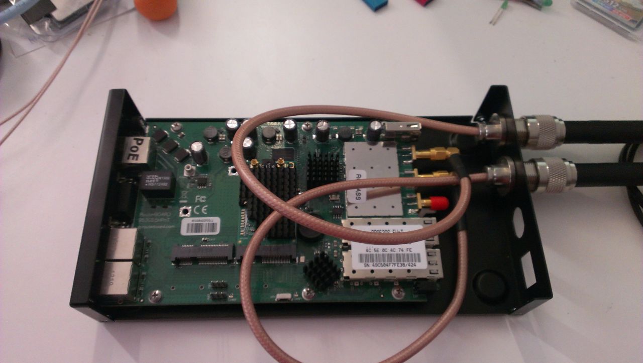

Just got my RB953GS-5HnT. CA/433 case fits fine ![]()

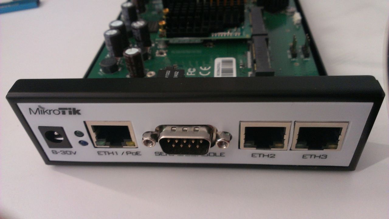

The cuts don’t match but there is enough space for pigtails (SMA to N) and sfp’s to fit inside the case. The SMA connectors and SFP cages have about 5cm of space to the rear-end of the case.
I will take a picture later today.

Here are some pics…
The pigtails I use in these pictures are a little ‘large’. Normal sized cable will fit fine.

Thank you very much. The pictures help a lot because I was thinking the PCB extends to the end of the case which it actually doesn’t.
