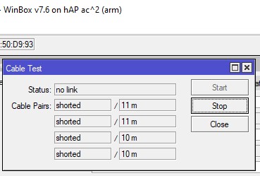

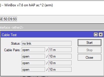

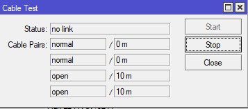

We have a Mikrotik. The initial cable diagnosis can be done with its cable tester.
Disconnect the other end of the cable from the equipment and test the cable, then repeat on the other side. For a more thorough test, you can make a pair jumper. A piece of cable with a connector or a socket that has each pair shorted.
If the cable is OK, the length of each pair will be approximately the same +/- 2m, and the cable length will be measured the same whether the cable is open or shorted pairs, if there is a problem with the cable/ connectors, the measurements will differ significantly.

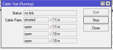

100 mbps equipment connected.Disconnected from AC
The orange pair is shorted at the far end
The link is connected and working
Is this what you mean by a pair jumper?
I just made it and I do not get any result in the cable test section
Some Mikrotik devices do not have a cable tester. Apparently 5009, the pictures show AC2
