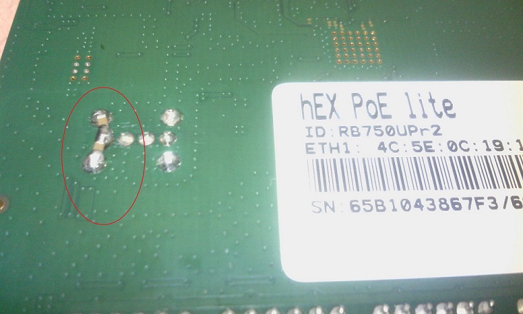

Never plug anything in usb port. It can output full power supply voltage during usb power-reset command.
The result is two dead LTE modems.
Screenshot to confirm that.

Is this related?
This equipment should have the same problem, hAP RB951Ui-2nD
http://forum.mikrotik.com/t/hap-destroing-3g-dongles/101083/1
@adver:
Can You specify, when this hEX is bought, or other details to clarify that this is the same issue like mine (the other thread) or it is about new device that should be considered as “fixed”?
I bought it two weeks ago, but it can be an old stock item.
I also wish to know, how to distinguish the “new” revision of the board.
If this is a “fixed hardware”, then i have a bad news
Seems they have the same usb dc/dc converter design. So this can be related.
I also have this on the MB, but testing via multimeter shows everything okay. Mine SN is 65B205427BB7.
