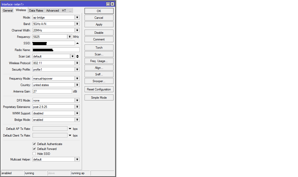

This doesn’t happen on any A/B/G hardware and I haven’t seen it on any single chain 802.11n hardware yet.
Does this qualify?
