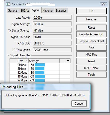

Hello I will first state my equipment:
2 x XR5 @ default power
2 x 29 dBi parabolic antennas
2 x 411ah RB
2 x 18 volt power supply and PoE
Having said this, I cant get the CCQ to get steady up to 100% please see attachment so you’ll know noise floor etc
I have swapped all components to see if I had a hardware problem
Thank you for sharing your thoughts
Any ideas please?
please?
100% is not possible, your value is very good.
Hello Normis and thanks for your reply!. I have to disagree with you on that since I have 2 links that show almost steady tx/rx CCQ 100% (the links are 11km and 15km). If you state that 100% is not possible, which would be the range for bad CCQ, ok CCQ, good CCQ, excellent CCQ, backhaul quality CCQ

Ya your numbers are very good.
30-40% is not good.
anything below 75% I try to improve but not every case can be perfect., Some links are 50% CCQ, result is generally less throughput.
100% is possable by the way just takes lots of playing around with everything
