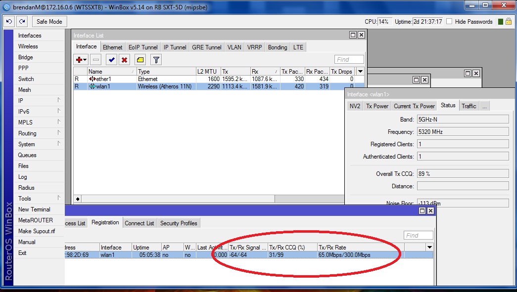

ccq and signal question
im trying to get the best out of my link and want some advice on the fine tunning
as you can see on the attacment i droped radion power to 15dbi on both ends and now my rx and tx signel is 64/64
what i is the best signal to work with or average as i dont want the two radios screaming at each other
as ive been playing with it from 15dbi and 18dbi
or the 2 radios
so if you could tell me more about your good links and the ccq and signel or even better config options
Look here for advices: http://forum.mikrotik.com/t/q-strange-ccq-with-dual-nstream-good-with-5ghz-onlyn/47379/1
  • Antenna alignment
    Freznel zone obstruction.
    Noise in channel selected
    Spacing between antennas.
    Distance of link and antennas used.
