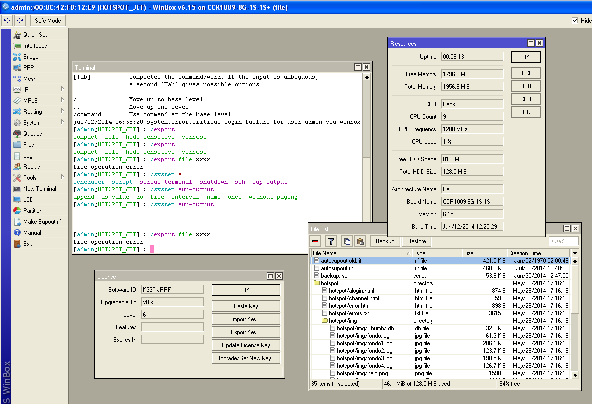

We installed on one of our clients a CCR1009-8G-1S-1S+ to work as hotspot and User Manager. After a few hours it started to fail. The failure consist in some different issues:
  • The unit loses admin user’s password. To log into the device it needs admin and blank password. After some reboots it comes back again.
  • User Manager reports error on log: failed to commit transaction: disk I/O error.
  • Unable to write anything to disk:
  • /export filename=xxxx fails to execute
    • Uploading through winbox fails (trying to upload last firmware version)
    • Uploading through ftp fails (trying to upload last firmware version)
    • /system package update upgrade failed
  • User Manager does not work at all
  • /system sup-output does not create a support file
The initial setup was made on RouterOS version 6.13. As sometimes it works after a reboot, I was able to install last firmware 6.15, but the issues still remains. It fails again sometimes after a reboot and sometimes after different time periods working properly.
