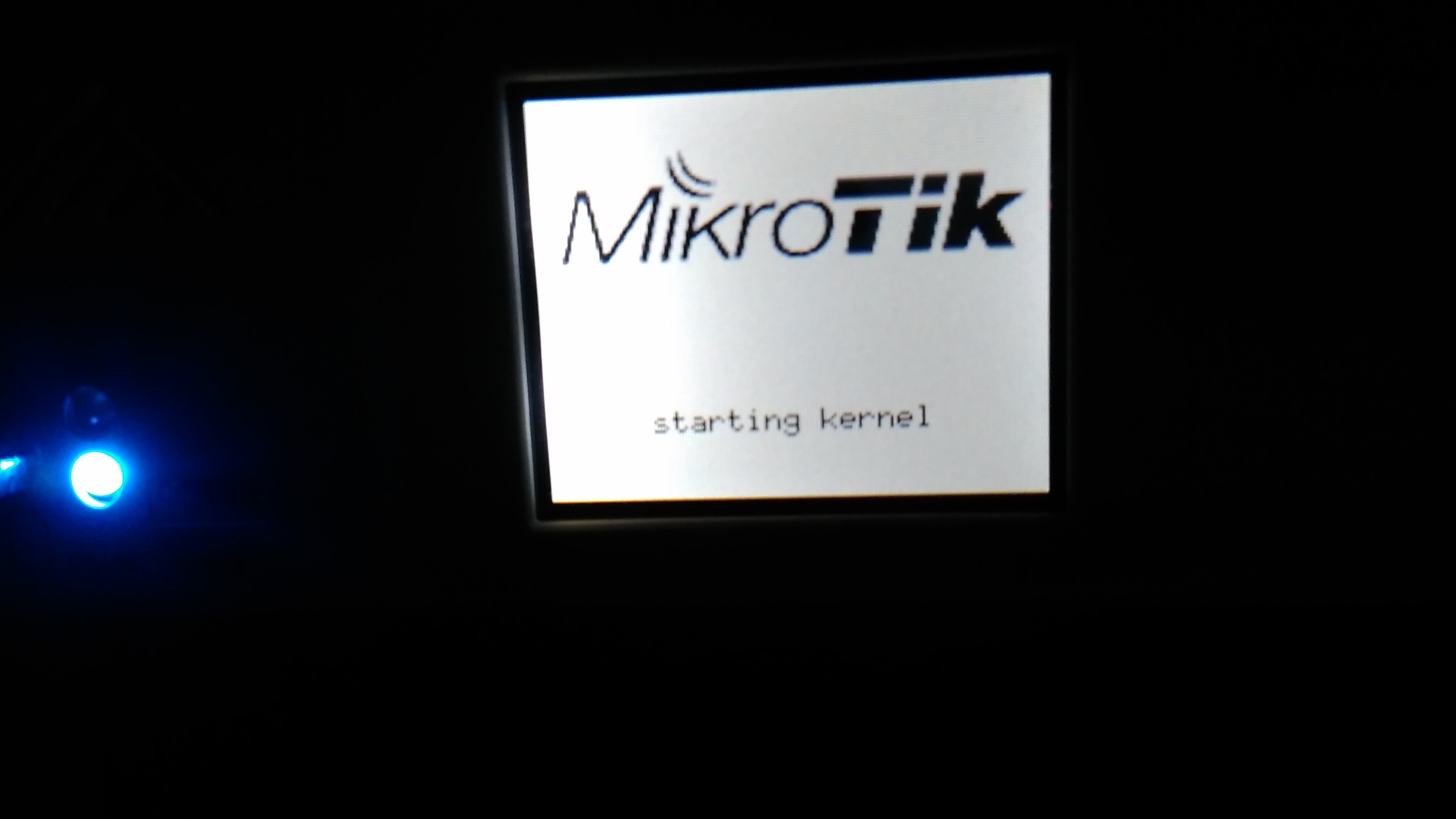

My CCR-1009-8G1S-1S Router Stuck at Starting Kernel. I also tried if I can reinstall the OS using netinstall but the router is not communicating. I think am not getting it right I need you to help to resolve this issue.

We have the same issue, on a CCR with The Dude running. The Dude consumed all the Disk Space, until it was 0% disk available.
I’ve tried to delete some files (old backup files) but we got the error “could not delete” Error 6.
I’ve restarted the router and now it’s stuck at “Starting Kernel”. How can we fix the router? How can we remove files from the internal disk so the OS can start?
Is there a procedure to fix the router without Netinstall and wipe the local Disk?
We have an CCR1016-12S-1S+ where the disk got full due to The Dude database.
The router is now stuck at “Starting Kernel”.
