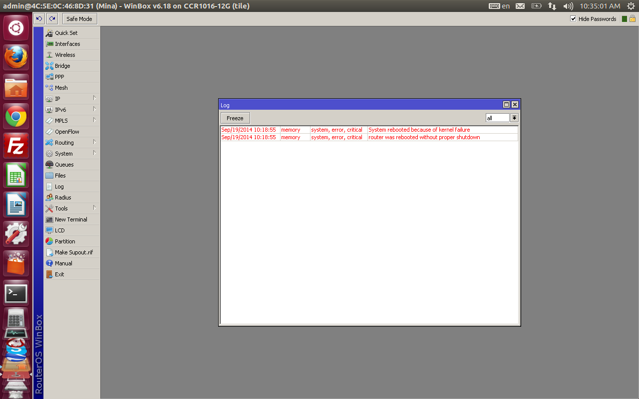

i have the same problem with version 6.19 , i downgraded to 6.18 but still having ccr reboots hazardiously , i have changed the queue interface from only-hardware to ethernet-default but with no luck .
i have sent a suppout.rif file to the support and waiting for reply , hope the problem will be fixed
this is a screenshot of the CCR 16 core log
