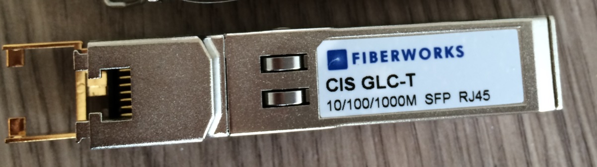

I have a CCR1009, and im using 1000BaseT adapters in both the SFP+ and SFP port. Works great!
The type I use is a Fiberworks GLC-T. And its essentially uoriginal SFP, thats programmet to work with Cisco switches. (on Ciscos 3750 switches it shows up as a original Cisco SFP).
Regards
ATG
