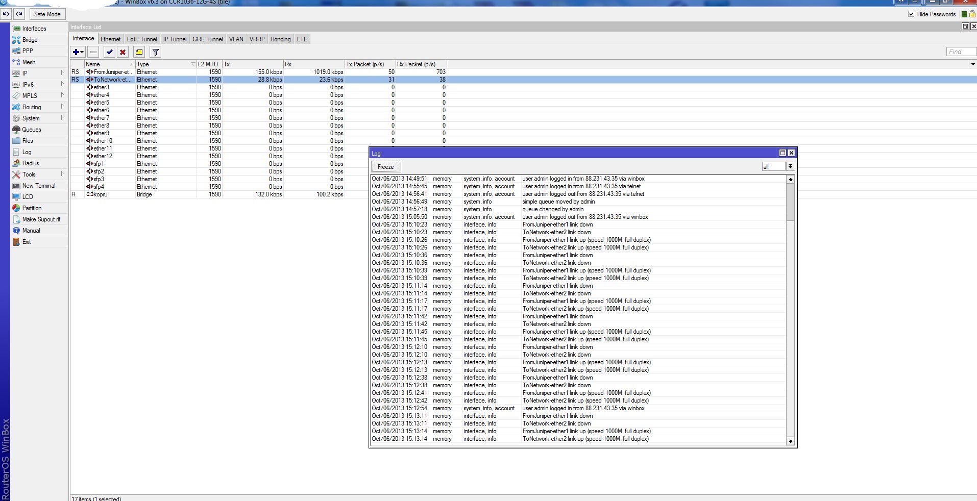

I Live same problem about 2 days.
Today the routeros disables the ports 6 times..
I dont know what can i do..
When i reboot the router, it works normal but after 1 hour it happens again.. there is no more than 100mbit traffic, today is Sunday…
CCR1036-12G-4S
ether1 - uplink
ether2 - tonetwork
using bridge these 2 interfaces…
Attaching screenshot..

  frame 20: 0xfffffff700496198 __udp4_lib_rcv+0xb48/0xc00 (sp 0xfffffe007c65f9a0)
  frame 21: 0xfffffff7004460a8 ip_local_deliver_finish+0x390/0x5d0 (sp 0xfffffe007c65f9f8)
  frame 22: 0xfffffff711e40da8 0xfffffff711e40da8 [imq@0xfffffff711e40000] (sp 0xfffffe007c65fa78)
  frame 23: 0xfffffff7003ffc88 dev_hard_start_xmit+0x750/0xaf8 (sp 0xfffffe007c65fac0)
  frame 24: 0xfffffff700425200 sch_direct_xmit+0xd8/0x390 (sp 0xfffffe007c65fb48)
  frame 25: 0xfffffff7004256d8 __qdisc_run+0x220/0x2b8 (sp 0xfffffe007c65fb88)
  frame 26: 0xfffffff7003f5780 net_tx_action+0x218/0x348 (sp 0xfffffe007c65fbf0)
  frame 27: 0xfffffff7000542a8 __do_softirq+0x208/0x388 (sp 0xfffffe007c65fc48)
  frame 28: 0xfffffff700054850 do_softirq+0xd0/0x140 (sp 0xfffffe007c65fcd8)
  frame 29: 0xfffffff700054de0 irq_exit+0xb0/0x1a0 (sp 0xfffffe007c65fcf8)
  frame 30: 0xfffffff700027000 tile_dev_intr+0x190/0x1f0 (sp 0xfffffe007c65fd08)
  frame 31: 0xfffffff7004f5060 handle_interrupt+0x1f0/0x210 (sp 0xfffffe007c65fd40)
  <interrupt 30 while in kernel mode>
  frame 32: 0xfffffff7004f4e58 _cpu_idle_nap+0x0/0x18 (sp 0xfffffe007c65ffb0)
  frame 33: 0xfffffff700029db8 cpu_idle+0x218/0x2b8 (sp 0xfffffe007c65ffb0)
Stack dump complete
---[ end trace 71169b09e1801d3b ]---
Rebooting in 1 seconds..
There is surely something wrong with this. Please have a look.
Seems I have similar woes… 1036CCR, 12G. 4SFP. V6.5
Set up a (copper only) bridge group and after adding a Cisco 7206 (100Mb copper),
noticed that every few seconds the link light went out for a second or two.
Unplugging the Cisco “sorted” the problem - but doesn’t obviously help me.
Whilst doing initial configuration, I had an SFP / optic connection to an HP switch - and
it all just worked…
now I have this feeing things are not working quite so well, the SFP connection to
another cisco just does not work, link light is on - no packets seem to leave the interface.
Go back to V6.4 ???
Followup…
Loaded 6.6
The Optic worked just fine once auto-negotiate was switched off.
ie Telling the Optic that can only run at 1Gb to run at 1Gb… hmmm
Got the same results - ports disable then return.
System got worse - and started rebooting every minute or so.
Left just the Optic plugged in - even that has since died (3 or 4 hours later)
The Optic was being given a full IPv4 and IPv6 BGP table. Looks like just one CPU does all the BGP???
Sometimes saw 3 CPU’s at 100%.
There was otherwise no traffic - I can’t get the CCR up long enough.
Was hoping to do diagnostics/reports from the comfort of home (Device is in Telehouse, Docklands, London)… but its dead.
I’m afraid I’m now looking for a Cisco NPE-G2 Engine!
