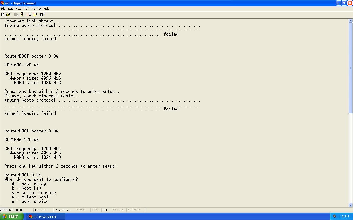

Please find null modem cable and access your CCR by console, check the output (if you have any problems with it, post your output here).
Dear Sergejs
I tried to access it via serial cable when i want to boot it via Ethernet it on the screen tell me check your cable? so changed cable and computer but same error message appear again.
for more detail please see attach screen shots you are requested, please advice.
Dear sergejs
thanks for your reply I am tried with your procedure but i cannot boot from ethernet please see attach files you requested.
Make sure that Netinstall computer is connected to Ether12 port.
Do you have proper “Net Booting” configuration?
